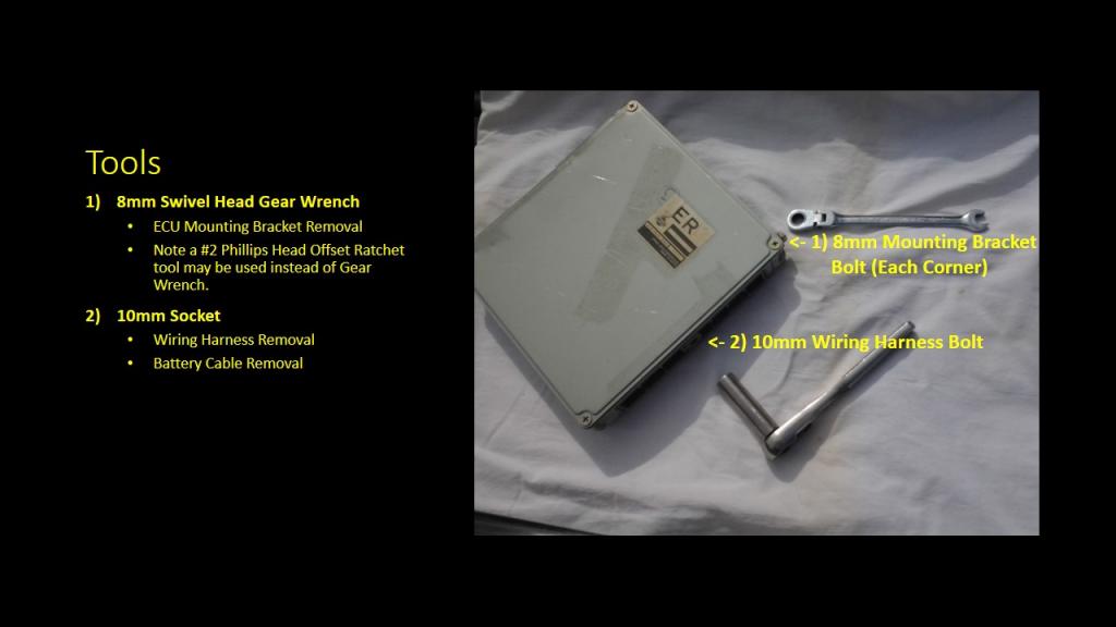

Here's a slide show I pulled together this morning after I removed the ECU from my 99 Maxima. I read some ECU removal instructions and was able to remove the ECU in about 20 minutes or less.
While I purchased a new Offset Ratchet Screwdriver Tool with a #2 Phillips, once I started the job, I quickly realized my existing 8mm Swivel Head Gear Wrench would stay mounted on the ECU bracket bolts and make removal go faster.

Tools

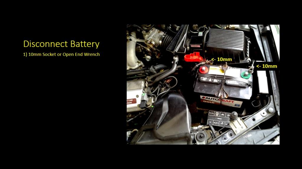

Step 1 - Disconnect Battery

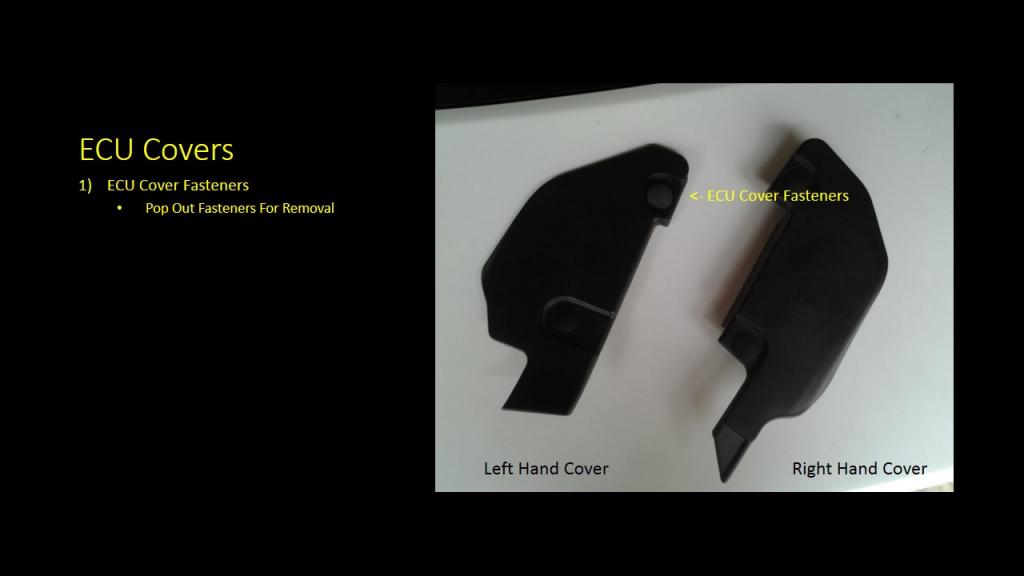

Step 2 - Remove ECU Covers

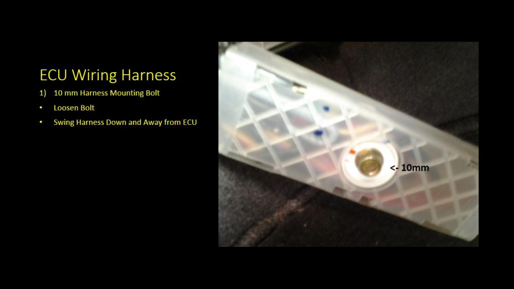

Step 3 - Remove ECU Wiring Harness

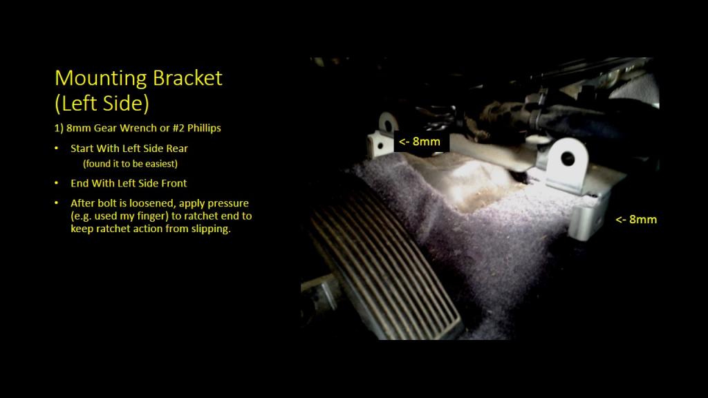

Step 4 - Remove Left Side ECU Mounting Bracket Bolts

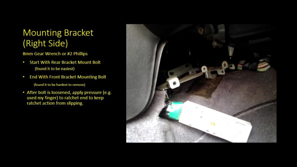

Step 5 - Remove Right Side ECU Mounting Bracket Bolts

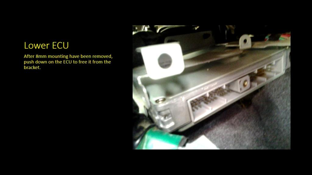

Step 6 - Lower ECU Away From Mounting Bracket

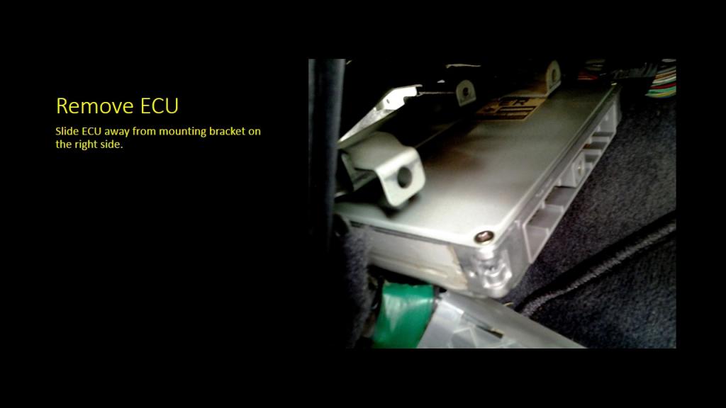

Step 7 - Remove ECU

I can't get a damn 8mm on those screws. How did you!?
Old Nov 29, 2014 | 02:15 PM
CS_AR's Avatar
Joined: Jan 2011
Posts: 3,037
From: Central AR
Hey Chris - It looks like the earlier models used #2 Phillips head screws. I had initially purchased a Offset Ratchet Screwdriver Tool with a #2 Phillips, thinking it would work.
On the 99 model. I was surprised/shocked to find 8mm heads. Over the past year, I've seen it both ways.
Old Nov 29, 2014 | 02:19 PM
Those damn screws on the passenger side are impossible to get to.
I have a offset ratchet screwdriver and still can't get to them. Driver side was a pain but they're off.

I read where somebody took some small pliers or needle nose vice groups and grabbed the screw by the head to start it turning.
You're not kidding it is PITA to remove the passenger side.

I removed the ECU successfully today. For the front passenger side screw, I was able to use a needle nose which loosened it easily.

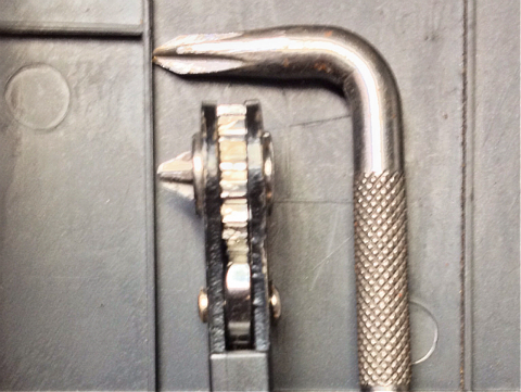

The rear took me a while. I couldn't get the needle nose on it but was able to trim down the Philips attachment for the Neiko tool to really shorten it up. Here you can see how much shorter it became compared to the offset screwdriver. Made the job a lot easier.
