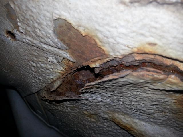

Hey guys. Been a while since I have been on here. So many new things happening. Looks like the rust is finally catching up to the car from being in Indiana from previous owner. I enjoy this car all the time so trying to take care of it. She at 356k and still running strong with very little maintenance. I have noticed this rust in the frame area. Dont guess it really the frame but I am sure it is structural. This area of rust is on the front left near the lifting area. As you can see the rubber undercoating is coming off and I pulled back on it and I can stick my finger through it in one area but the rest of it just feels mushy. I just looking to see how much I should be concerned.

Well that's not the frame. You should see my car! Damn Canadian snowy, salty roads. I think its your rocker panel. So simple fix, cut out and replace rocker. Or cut out and weld in new metal.

If im viewing this pic. properly it looks to be behind the sub frame so no worries there but it appears to be on the floor pan. Is it on the drivers or passengers side? If you say you can poke your finger through you could try taking out you seats and center console and take out the carpet and see where it's gone through then remove as much rust as possible and weld a new piece of metal in and coat it and have it undercoated after the repair. This is ofcoarse if your wanting to keep your car long term but if it's the white one you have pics. of there it looks pretty clean otherwise. P.s after re reading your post it sounds like it's obviously the drivers side floor pan.
Yea I couldnt think of the stupid word last night when I was trying to make this post. I couldnt get past frame lol I was looking for undercarriage but it never came to mind. But yes it is the drivers side. It would basically be the area right where the fuel door lever is. I dont have no intentions of getting rid of it. You just dont find cars as nice and stylish as these anymore and this motor is a beast compared to what out there today and gets the same fuel mileage as all this new crap out here. The electronics on these new cars are ruining things.

That's not the frame, the car is a unibody. That's nothing more then sheet metal. If you really want to fix it, all you need to do is cut out the rust and weld in a section of new metal. You can even rivet a section in, use a liquid weld or seam sealer to make it water proof.
