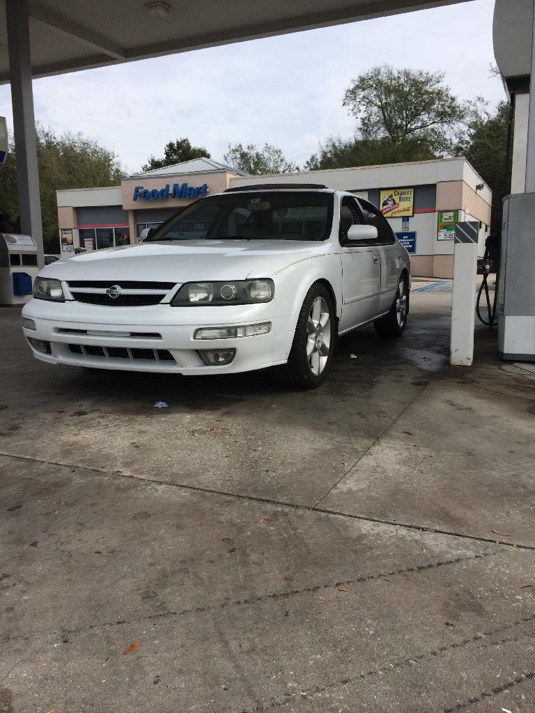

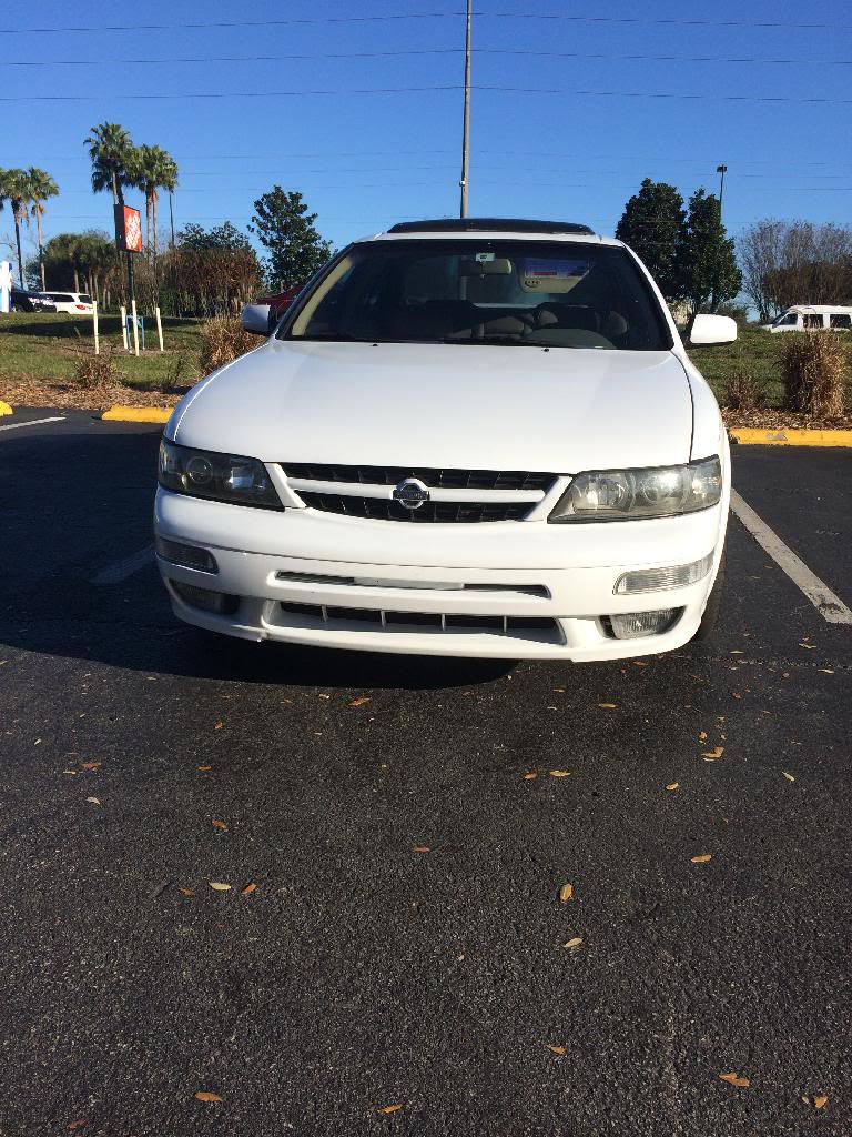

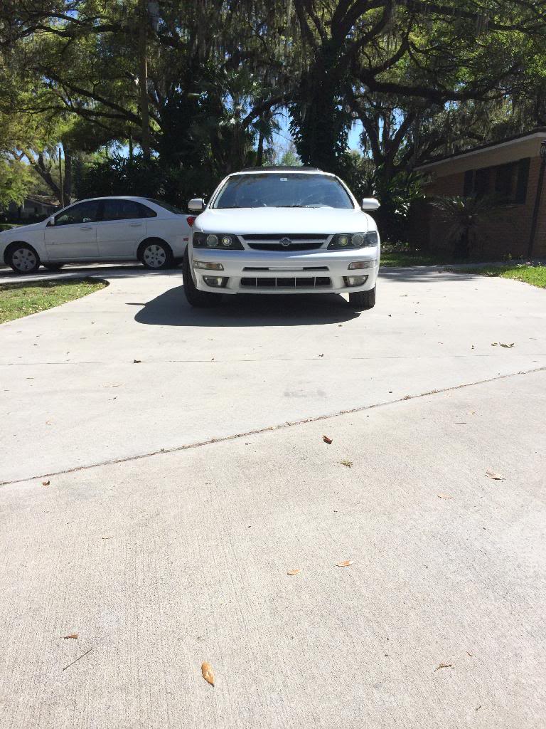

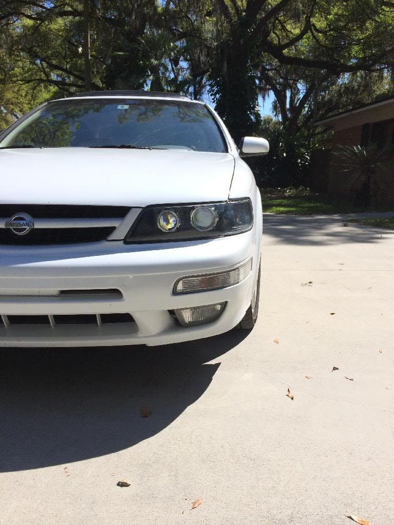

So finally finished my qaud retro here's a couple of pics don't have any output yet cuz it's not dark here in tampa florida but will post up later..
The before

The after

Before

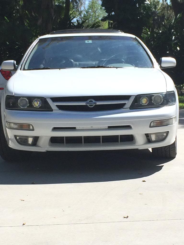

After

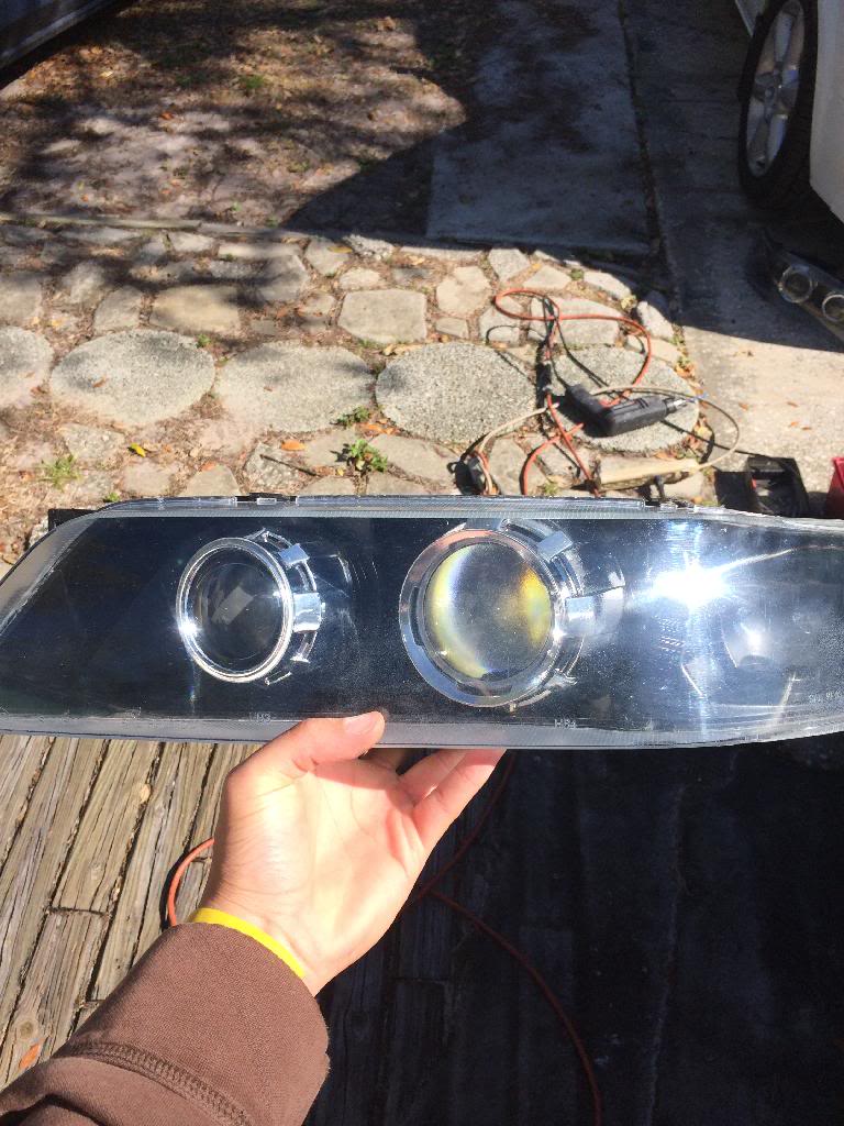

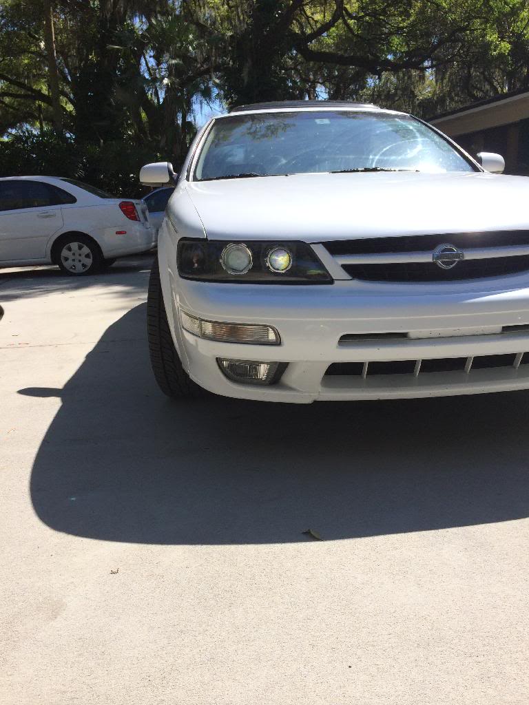

so you took the low beams from the old setup and made them the highs in the new?
Specs of the retro, please. Which projectors did you use?
No basically I have morimoto mini h1 (inner projectors) e55 projectors from amg g63 Benz (outer projectors) and they are both bi-xenon projectors meaning that each projector has high beam and low beam... So I'm running four low beam and when I want high beam I have four high beams ....

not bad in for pics of output
looks like you've got gatling/ mini gatling as the shrouds?

Originally Posted by tosheto
How did you do the rear blinkers? They look nice!
The turns were hard cuz nissan uses reverse polarity or some crap so the front turns run of a different current the the tails... How true that is I dunno but I didn't want to use load resistors becuase they get really hot so I used the stock bulbs and spliced into them for my load resistors ...
Yes mini gatling and regular gatling shrouds
