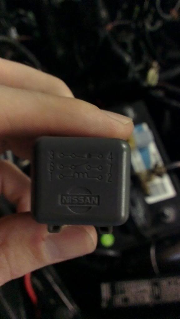

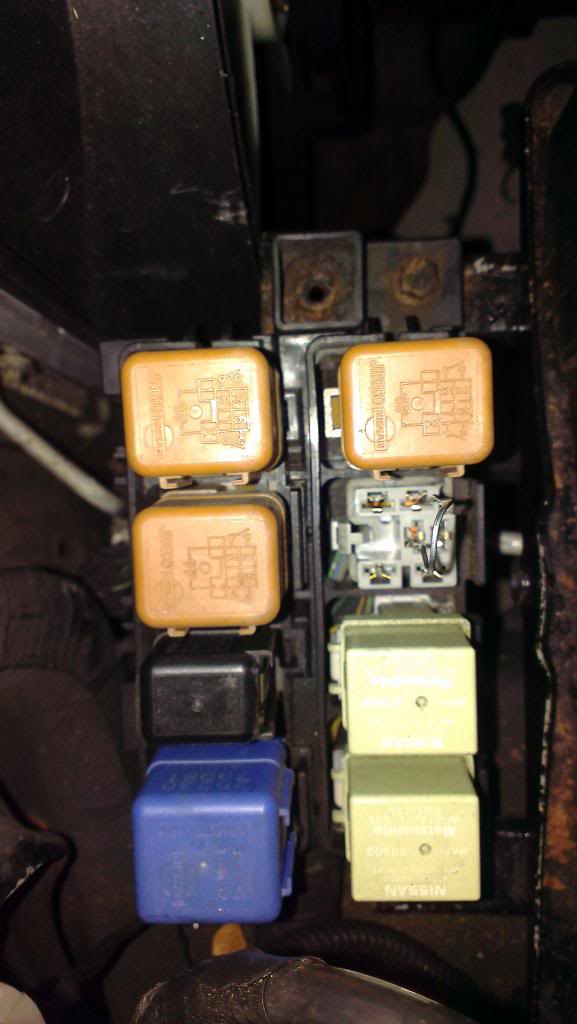

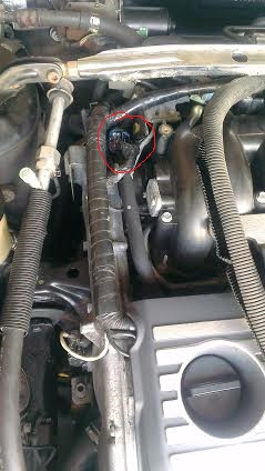

Pulled the Inhibitor clutch interlock relay out and put a paperclip in the 6 &7 slots, got the starter to spin and turn the motor over. Still no start. I bought a brand new relay and replaced the old one, but it went back to not doing anything! The paper clip still works tho.. Really really confused.... I didnt check yet, but I don't think I'm getting fuel either. Sorry for huge *** images lol.Name:  IMAG1249.jpg

Ok chaps. I figured it out. I read up on some NATS stuff. I tried a reset where you put your key in and out of the ignition 10 times, then try to start it. I grounded the two wires stated in the 5spd swap Howtoos for the clutch, and she started up first turn! So I am going to do a write on on how I did this de-k swap and add it to the now limited selection of info we have. Lotta dead links and pics. So everybit helps for ppl like me trying to do a swap. Thanks guys for your help on this!
