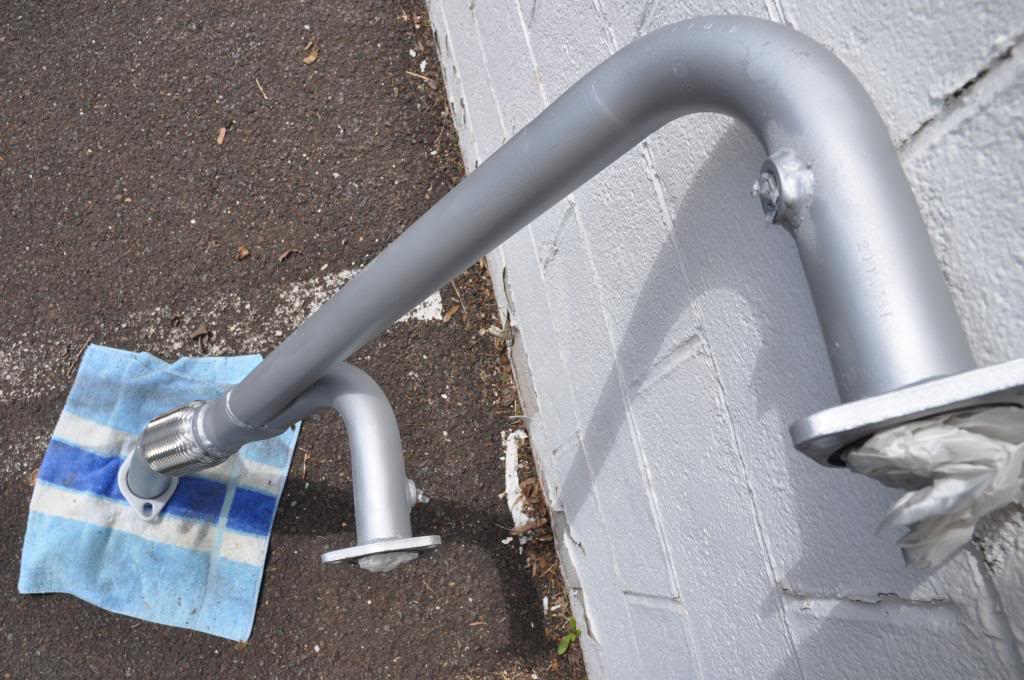

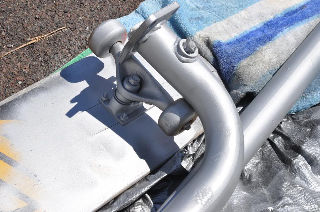

Old Apr 27, 2014 | 07:20 PM
max ride 41's Avatar
Posts: 6,789
From: in my max, pa. :p
ok, did 2 coats of the silver 2000 degree header paint today, perfect day for it!!! pics

Old Apr 27, 2014 | 07:50 PM
Quickywd01's Avatar
iTrader: (16)
Joined: May 2007
Posts: 3,078
From: NorthernNJ
Looks great. Just like mine.
