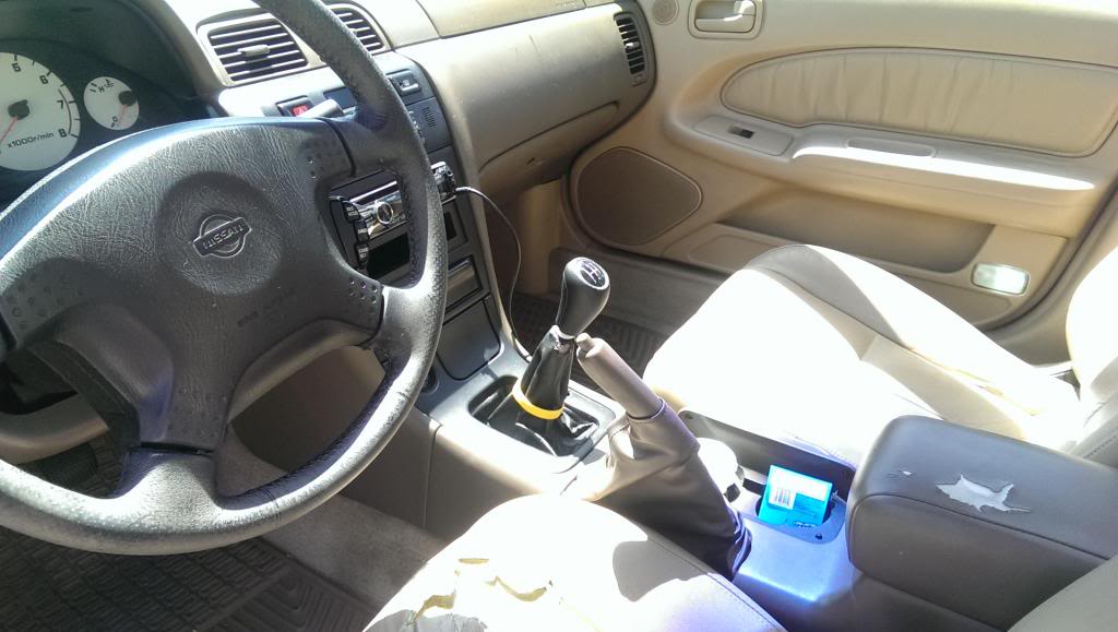

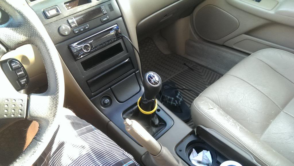

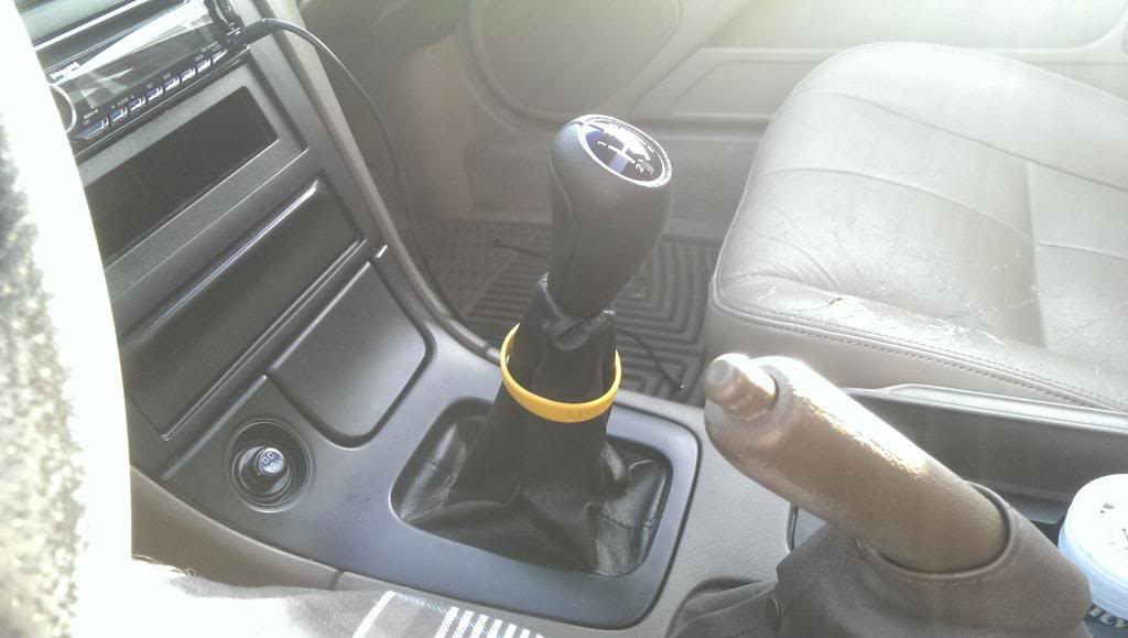

Hey all, it's been a while since I've posted here but I wanted to share my newest mod on my 97 Max. My old shift *** (misspelled to avoid censorship; lets see if it worked) was pretty well worn out and no longer had even the H pattern visible. I decided to go to eBay after checking the classifieds here and found a bunch of Evo ***** with the same threading, but ultimately went with a WRX **** with a 12x1.25mm spacing. In order to fill in the 2mm difference I wrapped electric tape around the threads and then wound the **** on until it had a firm hold. The WRX **** also has a plastic ring around the base which I assume is for reverse lockout but makes for a perfect zip tie holder to wrap the boot up around for extra flushness. Here are some photos to show the results. I'm super happy with it and the WRX shift ***** can be had for ~$30. The Max just got a small bump into the 21st century interior wise.
Side by side comparison:
After initial install with the white plastic showing:
After complete install with zip tied boot:

I actually got some adapters from 9k racing but they had a lip at the base that the **** wouldn't fit over so maybe I'll grind it off one day and make it more professional.
Also the **** is a bit heavier than stock so the weight makes it easier to row. 2nd gear feels much smoother than it did before. Used to be pretty notchy.
