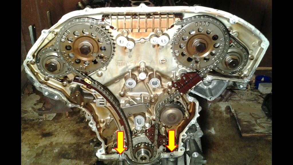

found the oil leak. I have the same leak and found out that there are two 0-rings behind the timing chain cover. The part number for the o-ring is 13035ha and 13035h. Here is the diagram of the cover and the o-rings.

No, because the seals are behind the timing cover not in the timing cover. That's why the oil leaks down and drips exactly on the oil pressure sensor and the oil pan because its leaking behind the timing cover.

The 2 big slabs are the outer timing cover and the inner timing cover. Oil splashes in that cavity between those 2 timing covers to lubricate the chains etc.
The area between the inner timing cover and the engine block is supposed to be bone dry. The O-ring leak on the engine block finds its way down this normally dry area and leaks out of the back area (oil pressure sensor, filter etc)
Is that correct?
What causes that O ring to fail? Is it simply age? Overfilling of oil? Infrequent oil changes? Or does it have something to do with the oil pump, which these O rings are sitting pretty much right on top of? (The pictures in this thread don't show the oil pump but the FSM pics show it clearly.)

Im a little confused too.. so to replace those two seals on would need to remove (in simple terms) the lower and upper oil pan, as well as the entire timing case, all the belts and pulleys, and all this stuff:
Old Jun 20, 2014 | 08:07 AM
metalgod3082's Avatar
Joined: Mar 2008
Posts: 221
From: Mesa, AZ
My vehicle had about 160,000 miles on it. Dwapenyi, yes you are correct it is the orings behind the inner timing cover so you do have to remove all the cam gears, timing chain, etc to get the inner timing cover off. It's not difficult just very time consuming. I spent most of the time cleaning off the parts I removed becuase they were covered in an inch thick of grease and oil from not fixing the leak for over a year.You have to drop exhaust, remove crossmember, power steering pump, belts, unbolt ac compressor and I believe alternator, upper and lower oil pan, all pullies, timing gears and covers. Just make sure to set the engine to TDC (Top Dead Center) before removing the timing gears so when you put it back together it's not difficult (FSM explains all this). Also, I probably could have saved a good deal of time if I had a pressure washer to to clean off all the grease so you could probably finish this in a weekend. If you have never replaced the water pump and the timing chain guide tensioner now would be a good time to do those as well while you're in there.
