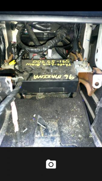

The BCM is on the transmission hump in front of the shifter by 6 or so inches. If you have auto trans, the BCM sits on top of the TCM, otherwise it is by itself.
The fuel pump should run for a second or two when you first turn the ignition switch on to allow you to start the car, but after that the ECU will turn the pump off if the ECU does not detect pulses coming from the crankshaft sensor that senses the flywheel teeth, CKPS(POS).

I noticed check engine light wasn't coming on at any point..followed power from batt...when I was pulling fuses checking one by one I put the fuse in a blank spot...put it where it went...fired right up...
