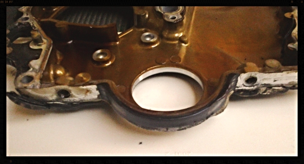

Do you know if the upper oil pan was removed to replace the worn seals and fix the oil leak?
There are seals that make contact with the upper oil pan that are named "half moon" seals as shown in the picture below that begin to leak as the car ages.

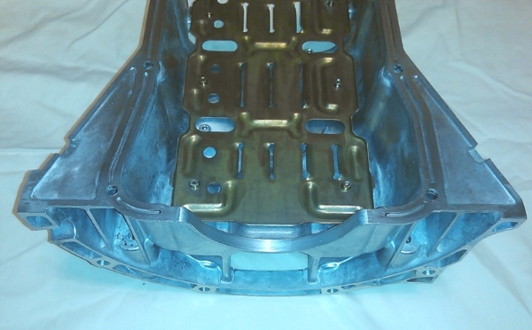

There is a mating surface from the upper oil pan on the engine to the transmission that supports engine to transmission grounding. The mating surface between the upper oil pan and the transmission should be clean before reassembly like the one in the picture to facilitate a good ground.
Another possible area to check is a vacuum leak that could be caused by a vacuum hose that was not properly reattached or was damaged during the work to fix the oil leak.
