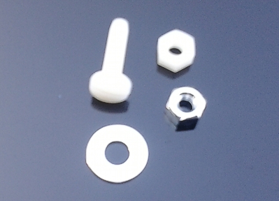

Ace Hardware carries nylon screws and nuts in the Hillman Fastener section. I picked up the items in the picture to replace the plastic bumper. I like to replace plastic bumpers with a nylon screw to prevent causing any metal-on-metal contact with switches.
Here's a picture of the brake light switch with the plastic bumper replacement. Sorry for the focus as I could not see the part when holding the camera.
