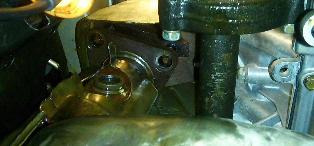

Old Sep 9, 2014 | 06:53 PM
CS_AR's Avatar
Joined: Jan 2011
Posts: 3,037
From: Central AR
Originally Posted by Fakie J Farkerton
Stare at them harder. They will move.
Soak them in PB blaster if that doesn't work.
If everything looks wet in this pic, its because it had been soaked with PB.
