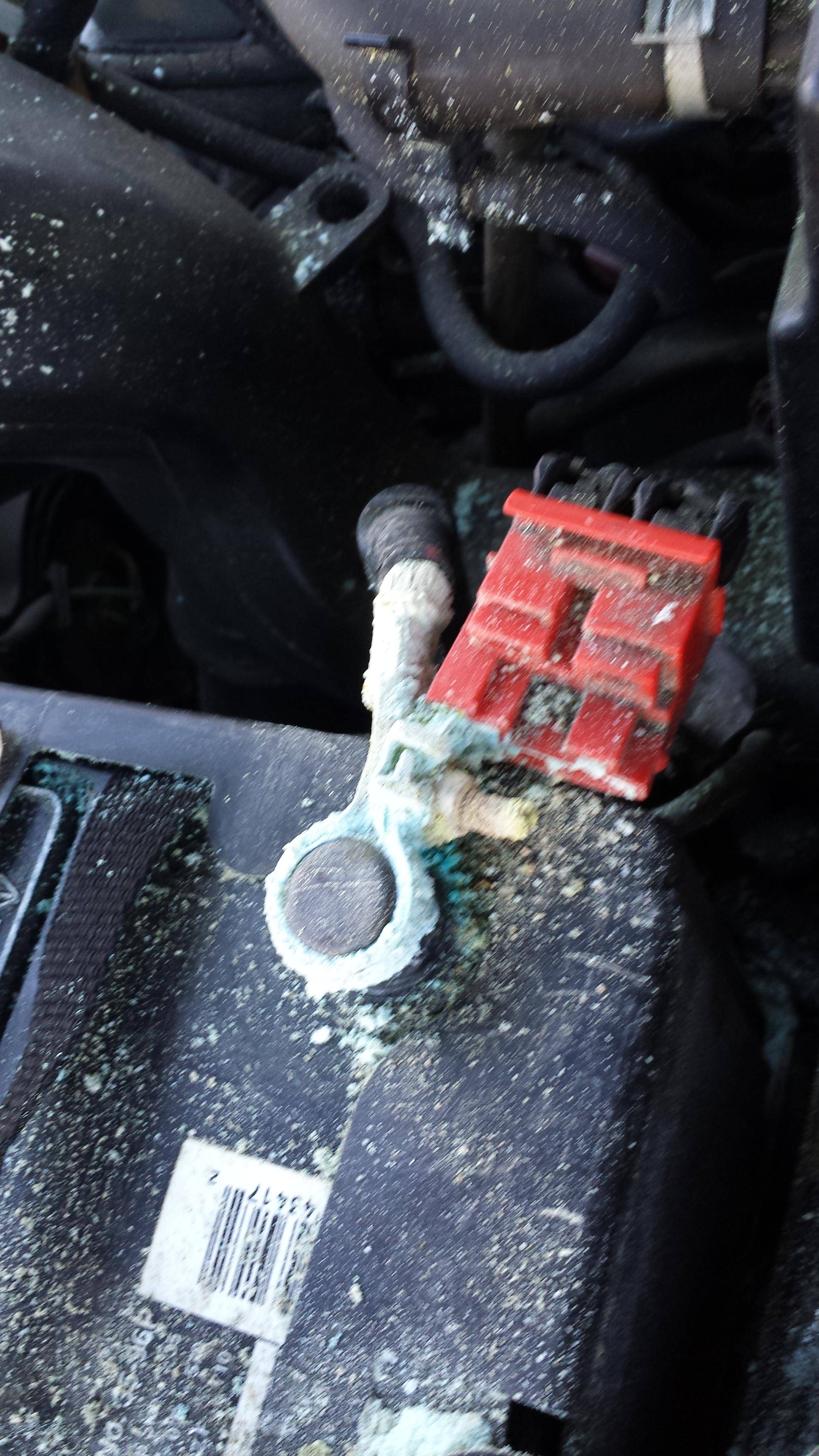

There was! I poured as much water and baking soda on it as i had.. but i could litterally see it inside the cabling. The amount of blue corrosion was unreal.. it was like the size of 2-3 golf ***** on top of the positive terminal! What in gods name makes this stuff grow?
I cleaned it off with a brush only to return a week later to find more stuff..

Thats when i grabbed the baking soda!
