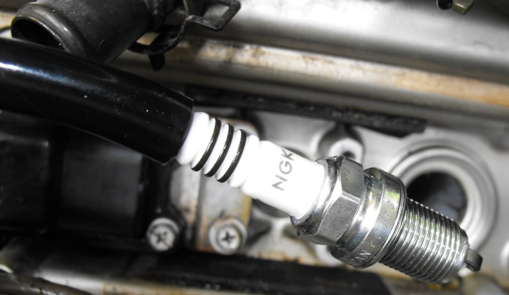

Now there's an old hemi-head plug installation trick. I use a piece of extra fuel line hose to start plugs. It works also when you have a plug in a tight place that may be difficult to reach.
