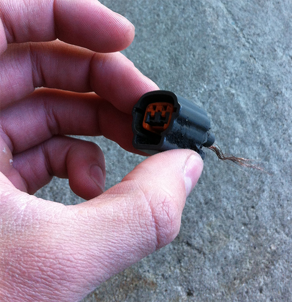

Also, anyone know a part number or title for this crankshaft sensor plug in connector? It's part of the harness that connects with the oil sensor/sender plug in next to the oil filter. It's what plugs into the bigger female CKP sensor itself. Mine was frayed and was nearly ripping off so just yanked it haha. Wait.. uh oh.
For the connector, go to the wrecking yard and get one, probably from any Nissan of the era, and solder/shrink wrap it it on.
Crankshaft Position/Oil Pressure Harness Rework

Pick up a terminal release tool for peanuts at Radio Shack or off ebay/Amazon and reuse your harness plug. I'm sure the tool will come handy in the future too.

Terminal release tool? Hm, I was thinking of reusing it but didn't know how to actually open the plug up to release the leftover wires inside it. I'll look into it.
