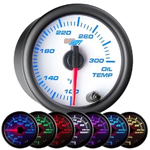

Decided to first get the oil temperature gauge. Got the glowshift brand as it seems to have the technology of autometer but a bit cheaper.
Suppose I will do a write-up on it for future readers
^^^been there done that.. waste of time + $$ + space.
conclusion: Oil Temp gauge on a SC'd maxima is totally useless. with MEVI, 2.87 pulley, EU fuel + timing tune, the oil temp never got higher than 220deg after 7 back to back hard presses from 40 - 120+mph. Oil temp would normally just stay at 170-180deg.
[on a N/A maxima, oil pres gauge is even more useless than a chained anchor]
Oil Pressure + Boost + WB AFR is the only gauges you need in a boosted max, Everything else is money wasted/attention diverted from what actually needs monitoring.
