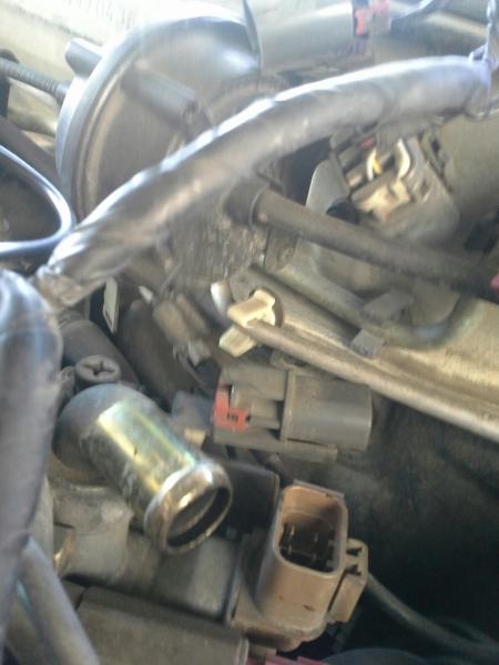

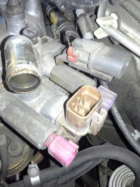

Cashoit WINS.... His suggestion:
"Sounds like you Idle Air Control Valve is on its way out. If the car hesitates only at idle but drives completely fine, then the MAF is good.
Test IACV per FSM. Clean per .Org procedure. Throw some chevron techron in that bish!"
So I followed his direction. I replaced it with one with 85k miles, and cleaned it well withcarb cleaner and brass wire brush, making sure when reinstalling I had the o'ring installed. I carb cleaned the intake and wiped down with rag. I also flushed in the inlet pipe with carb cleaner until it ran out of port. After reinstall I again filled the inlet with carb cleaner, replaced hose. With th carb cleaner soaking in the valve it was cranky to start, but with gas it finally caught and runs like a new car again.
Car is in Denver Colorado and probably has is entire life.
Thanks to all who offered suggestions. Success is sweet.
Here are some pictures of the unit.
96 with 230,000 miles. stutters in drive at a stop. goes away in neutral.  Automatic-iacv.jpg
96 with 230,000 miles. stutters in drive at a stop. goes away in neutral.  Automatic-iacv-above.jpg
96 with 230,000 miles. stutters in drive at a stop. goes away in neutral.  Automatic-iacv-position-top-engine-left-side.jpg
96 with 230,000 miles. stutters in drive at a stop. goes away in neutral.  Automatic-6-pin-socket.jpg
Oh almost forgot. I AM PUTTING THE E3 PLUGS BACK IN. THEY PERFORMED VERY WELL AND I DID EXPERIENCE AN INCREASE IN GAS MILEAGE.....

So I finally got a code off of her p0130 bank 1 02 sensor I checked it out yesterday and it is right below the rear valve cover, the old gasket leaked all over it, so gonna pull it and try to clean it, I don't get paid for a while so it's my only option right now, that and the wires look 20 years old lol, I'll let you guys know how it goes, the first time I started having this problem the person who I bought the car from forgot to clip the tps to tcm harness down, so I think it might be tps sensor related for you because mine revvd up to about 1200 when it was not connected well
Old Jan 18, 2015 | 08:01 AM
JoshG's Avatar
Joined: May 2013
Posts: 1,543
unconnected, bad sensors can do all kinds of things... Like right now I have a EGR/knock sensor job to do, but I want to do it right. I could do it right now since i have the $ for the job, I want to install a OEM nissan knock sensor in there.. I do have a $11 knock sensor with me but I dont think those would last long compaired to the $100 OEM knock sensor..
but those 2 codes make my car run aight, sometimes my car stays at 1.5k RPM while driving as if something was clogged.. hence EGR , I can Rev to 4-4.5k RPM from a complete stop.
Knock sensor- sometime when i drive I feel "metal" is vibrating which is telling me the knock sensor metal part is cracked and makes metal vibration sounds when i drive..doesn't make those sounds all the times though.
btw only have 134k miles.
