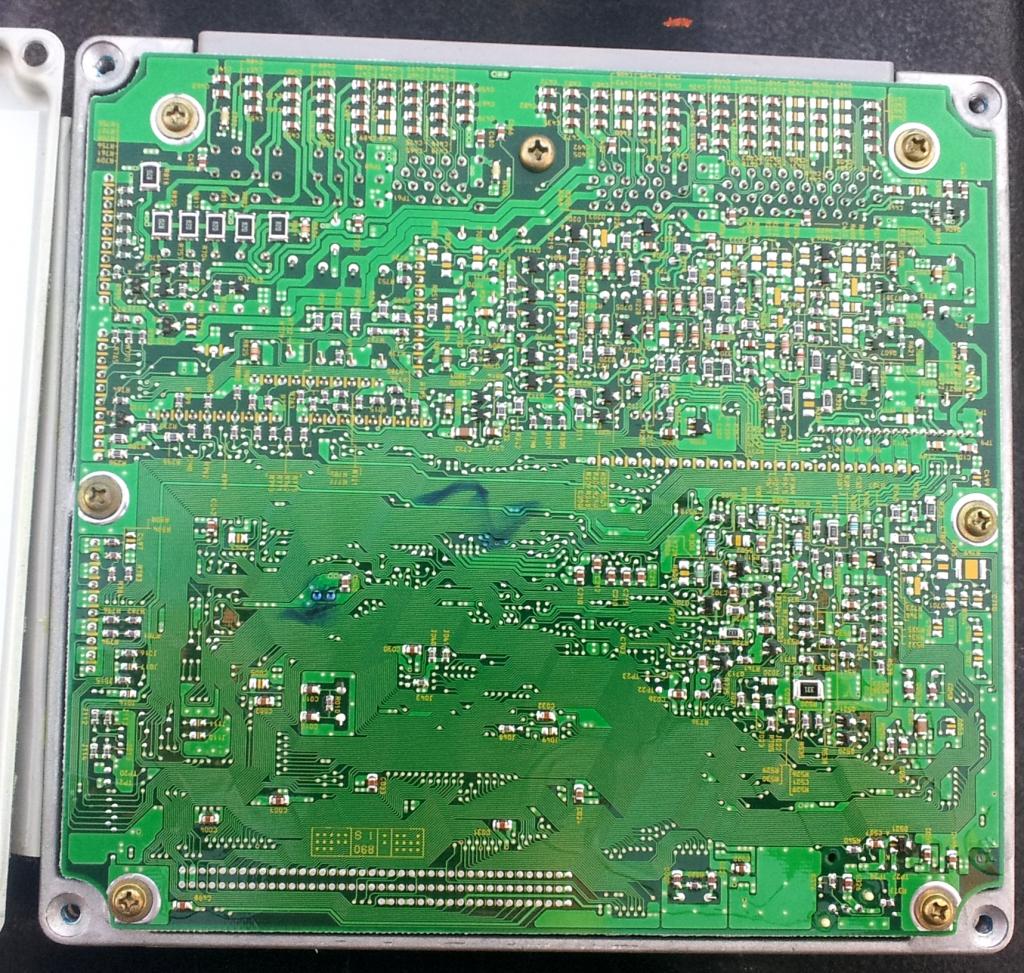

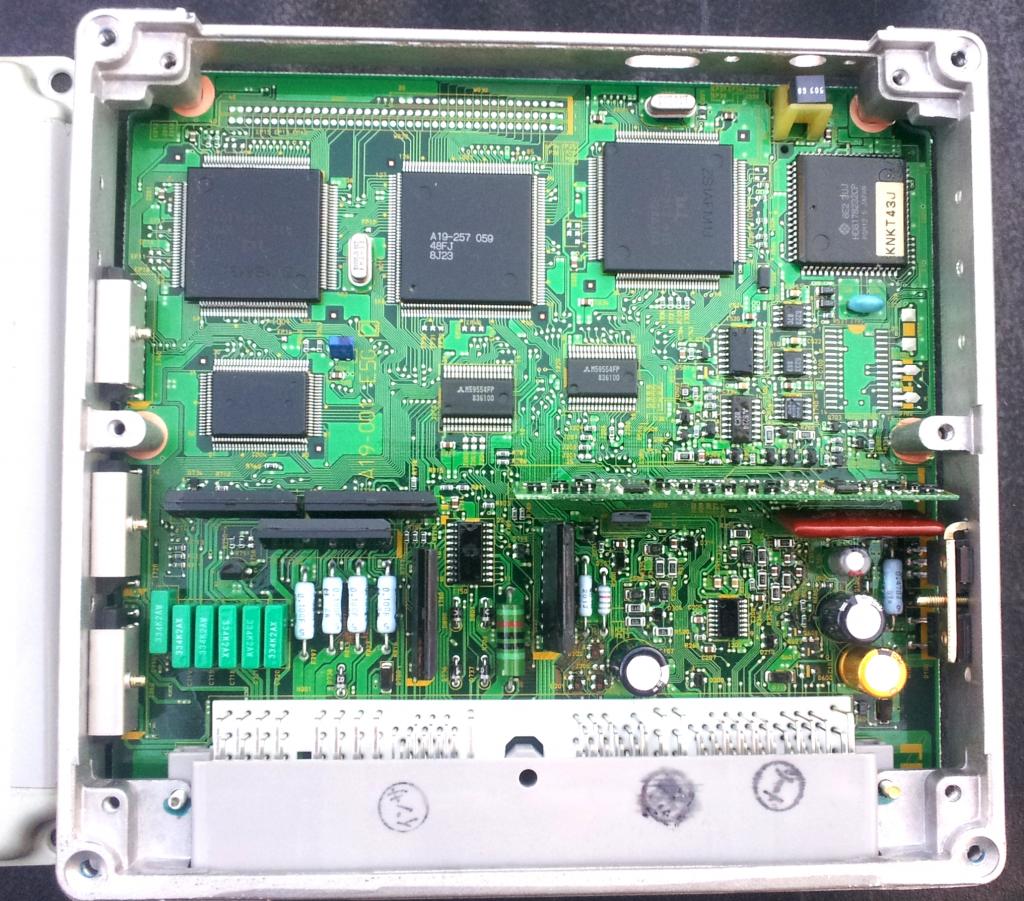

Pulled out ECU to check for obvious damage before suspecting IACV for rough, erratic idle under load, looked good. Tried to pull codes from ECU with screw, but nothing at all ... that's when I realized the CEL bulb was burned out, so replaced it, works fine now.
I've researched the idle problem ALOT ... just got the CEL for 1st time since all this work (otherwise, everything started right up, completely better after the chain tensioner re-pressurized lol & runs great btw) ... got a beautiful P0305 (sent by the un-gunked CKPS I assume), replaced the Coil Pack #5 & the idle problem was gone!

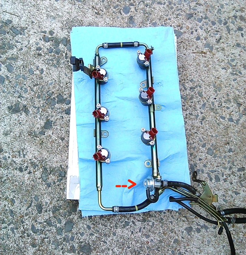

Jen - Are you noticing any differences with the #5 plugin terms of blackening or fuel smell?
The reason I'm asking is we are seeing some number of injector leaks that cause misfires due to flooding.
I remember having injector pintle cap/o-ring failure on cylinders #2 and #5 that caused serious flooding and misfires.
Two other members have experienced broken pintle caps / leaking o-rings -- possibly on #5.
Threads of interest below.

New plan ... More Spring Cleaning ... Injector O-Rings
^ Thanks for the nudge in a GREAT direction CS_AR! Didn't notice any blackening on #5 but didn't inspect the spark plug ... Old coil pack didn't look that bad physically, not a strong enough fuel smell to startle me, but ...
Read both threads you suggested & I'm diving in...
No SC setup like Wizard lol, but ALOT of similarities ... no billowing white smoke or backfire, no cranking issue (just put new starter, batt & alt in), just wispy white smoke & the putt-putt, guessing I might be in an earlier stage? Was already doubting the health of the cat, so after reading his experience, I'm almost 100% mine is already toast due to this issue, or will be soon ... no emissions test due til Sept, so I have a little time.
Got the 3 codes that all pointed to the Left Front O2 Sensor last year when I got the car, so just replaced it ... really don't want to fry it so I'm gonna do the right thing ... the UIM is coming back off.
I don't think I'll have the injectors serviced, I just didn't realize this issue and that they were RIGHT THERE, when I had everything apart the first time around ... live & learn! At least it will be alot easier having already done it once
I'm ordering the full O-Ring sets from rockauto with the top insulators because I do have alot of corrosion (plus I'll replace the FPR while I'm in there). Assuming I most likely have pintle issues as well.
Spark Plugs are brand new ... I'll of course check the injectors for function & be sure to update with photos & details of what I find once I get in there. Said it once & I'll say it again ... this site is amazing ...thanks!

Pintle caps, o-rings, and screens if you can get them.
If you open the injectors and replace the FPR, you'll want to replace easy to strip brass Phillips head screws with stainless socket head cap screws. I pick up Hillman Stainless Fasteners from hardware stores like Lowe's or Ace Hardware.
Injector Caps and the Fuel Pressure Regulator use M5 (size) 0.8 (pitch) x 16mm (length) with M5 lock washers.
If you have a good shop that can clean and service your injectors it is a lot less work. Though, I used this kit to refurbish mine last year.

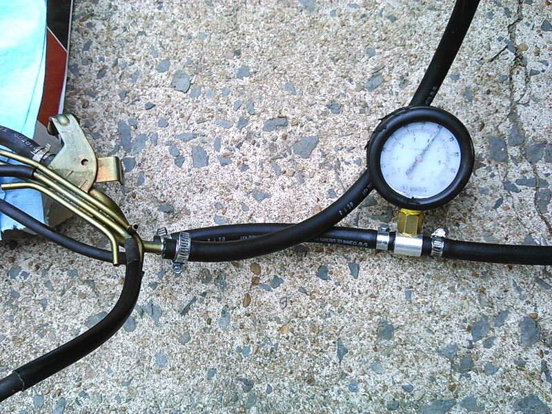

SO ... As suggested, because I was still getting multiple misfire codes (& ignoring the KS code for now),already replaced coil pack #5 due to earlier specific code & 99's are known for coil packs going out (220K now, were all original) ... I bought another 5 coil packs to replace the 5 remaining originals. Spark Plugs were still new from earlier work last year.
I also got the suggested Ebay fuel injector kit to refurbish the originals - came with screens, both o-rings & pintle caps. I did not remove the fuel rail - I very carefully with strong, steady twisting pressure, pulled them out of the installed fuel rail one by one. Upon inspection, very gritty & dark screens, o-rings didn't seem too brittle but the grooves they sat in were sludgy, and all the pintle caps were there but some had the little teeth broken off. Screens & o-rings came off easily & the new ones were simple to install (I did coat the new o-rings with a tiny amount of clean motor oil).
This is the point where I might have caused a problem - I don't know how picky/delicate injectors are, I tried being as gentle as possible, but I had some pintle cap issues - the old ones were brittle but so tight I had to carefully cut them off at an angle with the tip of a pair of wire cutters - I only VERY slightly nicked a couple of the pintles on the SIDE, not bottom, in doing this. Then I thought that would be the worst of it but it was even more difficult to get the new ones ON - I used a tiny rubber mallet to lightly tap them (afraid to hit them too hard) but I still had to work them on to get up over the groove with pliers, again, as gently as possible, but I did get them on - wondering if they are supposed to spin in the groove when on or should they not move at all? The edges are a little mangled from being gripped with the pliers and I did break one tooth off one of them. At the time, I debated even putting them on because I read some posts here on the org about people leaving them off & having no issues - I went ahead tho, figuring there were many more broken teeth before the process so only one missing on the new caps wouldn't be any worse than before. That's what I get for trying to think at 2am
Next, I got to eat a little humble pie ... On first startup trial, cranked fine, but no start ... expected since I had the injectors out & fuel line depressurized, but still no start after several attempts ... heard evidence of fuel pump working & re-pressurizing when turning key to ON position, but no start. Worst feeling after all the work I did BUT I kept calm & jumped into more research - quickly realized I needed to re-check all the connections, hoses, plugs, clamps, etc. that I removed & replaced to do the job. The first time I took the UIM off last year, I was so new & careful, I labeled everything as I did the disassembly to make sure I put it all back together correctly. This time, I got cocky, having done it before, and did not. Turns out there were 3 things I missed: I left off the small hose that attaches to an inlet a little left of top dead center on the UIM ... the electrical connector on the left end of the rear bank (not sure what for, bf guessed something to do with fuel delivery), was plugged in but not CLICKED fully into socket ... worst of all, when I replaced the fuel pump fuse inside the dash panel, it was supposed to go back in its slot #32, but I saw the only other empty slot a couple down the column and put it there by mistake (#34 I think, which is normally empty). Still thought I hadn't done too bad considering I hadn't labeled anything, BUT we made all those start-up tries with those three problems, which I am hoping did not cause any damage.
Once those 3 things were corrected, it still would not start tho, so I went back to more research ... thought maybe spark plugs got wet, so we pulled #3, being the easiest to access, and it was dry, no gas smell. No gas smell around fuel rail & injectors. When I installed the injectors, again going for the gentler approach (saw pros and cons for both hammer-tap and retainer cap method), I just set them in evenly, no pushing, and as I installed the retainer caps, I went back & forth between the two screws, which gently pressed the injector into place as the cap went down ... they all look seated properly, level with surface of orifice & even, same as they looked before. After visually checking the one spark plug & injector seating, we tried again and this time it started on about the 3rd or 4th attempt!

As I recall, the new pintle caps fit tight, very tight.
To install the new pintle caps, I matched up a barrel socket that was the same size as the cap. I just placed the cap into the socket then pressed the injector into the cap. The socket was the guide. So with the socket on my workbench, I just held the injector in my hand and leaned into it forcing the tip into the pintle cap. Then I adjusted the cap position so the little tips looked like the ones on a good injector.
Since you have a 99 model with NATS, be careful to keep the drivers door closed if you are running the starter for diagnostics. It is easy to accidentally trip the NATS immobilizer which can require a trip to the dealer for a reset.

I have some pics of the injectors & pintle caps before & after I'll get off my phone & put on here a little later ...
I do tend to get wordy lol, so here are the specific questions I still have:
Is it possible I confused the hell out of (or damaged) the ECU with all the different condition start trials I put it through?
(Maybe wait till I get my photos up, but...) Did I screw up the new pintle caps? They were in no way loose or spinning once installed & only sides got mangled by pliers...
Is it possible to OVER tighten the idler pulley bolt? (not talking about the tensioner bolt...)
As of now, later today my plan since I already have the battery disconnected, is to get some good gas in there, pull the ECU out to at least make sure there aren't any visible scorch/burn marks I may have inflicted, re-connect the battery & see if I pull any existing codes from the ECU, and then clear everything out (just to be sure) with the ECU screw.
Then, I assume I need to start the engine to see how it runs with the new gas & see if I get any new codes. At least this much should eliminate everything BUT the injectors and/or help point right at them ... will update soon ...

I actually had an ECU chip fail that kept my 99 model from running. I pulled the ECU and could not see any damage. The ECU shorting and board problem seems to be more likely on a 5th gen.
Here are some pictures of a bad ECU from my 99 Maxima. We couldn't see any issues from a visual inspection.

When I refurbished by 4th gen injectors, I tested the rails for leaks before reinstallation. I used the fuel pump on another car to run the test. All I did for the test was to close the loop so constant pressure could be maintained on the rails and injectors. I used the pressure gauge to tell me there were no leaks. This test can be performed on the car if you have doubts about leaking fuel.

On the car fuel injector testing. All I had to do was close the return fuel line to close the fuel loop and then close the supply line to prevent leak back once the max pressure had occurred.
