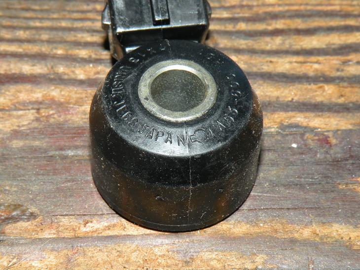

Does this look like an OEM JEGS with the Nissan Logo and all?
Actually the part is a SMP Intermotor (www.RockAuto.com) from one of Nissan's Just-In-Time supply partners named Federal Mogul.
Here's a video for the 1/4 inch drive with universal joint and extension to reach under the intake. I use the same approach.

The part I bought did not claim to to OEM, but with all the markings I believe it was. I paid $10 for this.
https://maxima.org/forums/4th-genera...ck-sensor.html

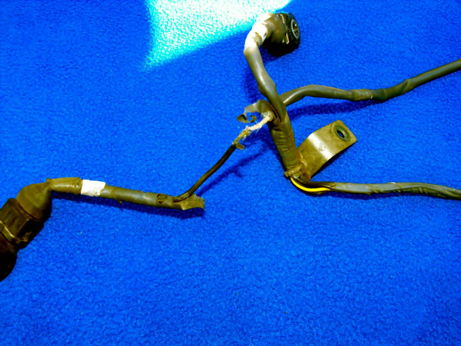

Look at the bright side. Replacement could be a lot worse. It could take 2 to 3 days of work to reach knock sensors buried under layers of UIM, injectors, and LIM like it is on a VH.
At least we don't have to worry about our KS harnesses being chewed up by some varmint. Actually some harnesses insulation material is made from a soy product that must be a tasty treat for rodents.

You are using the approach that I have used on three VQ30DEs. I just tighten it up with a 1/4 inch drive and a universal joint.
Can you check for a loose or broken connection? Was the KS wiring harness replaced with the sensor?
I bought a sensor/harness combo (they were already connected) off eBay for $20 from someone with good feedback. Connection definitely isn't loose where it attaches next to the valve cover.
