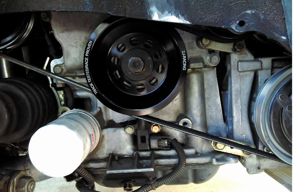

Originally Posted by aackshun
2j racing
Hrmmm I'll sell my UR UDP for that much, other than that I'm keeping it.
On a real note I wonder if one can bolt the trigger ring to a 2j racing pulley.... I'll take a looksee....
You're out of the loop bro. I did that just shy of a year ago.

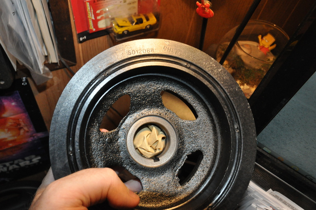

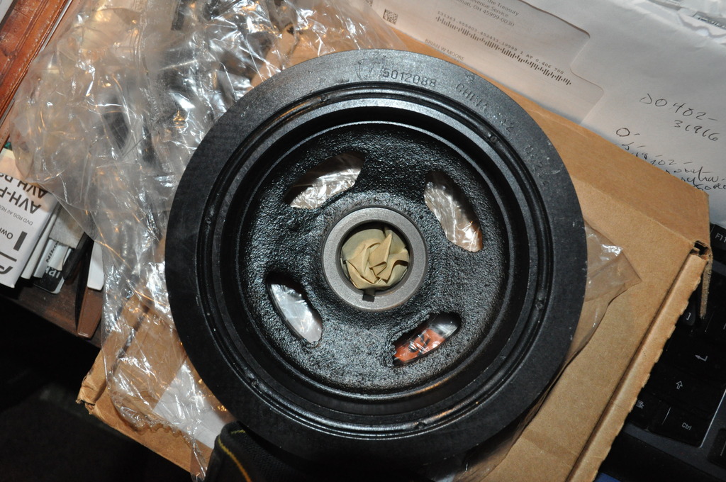

crank pulley finally showed up, it's a dorman for sure. checked the numbers, all good. pics...
