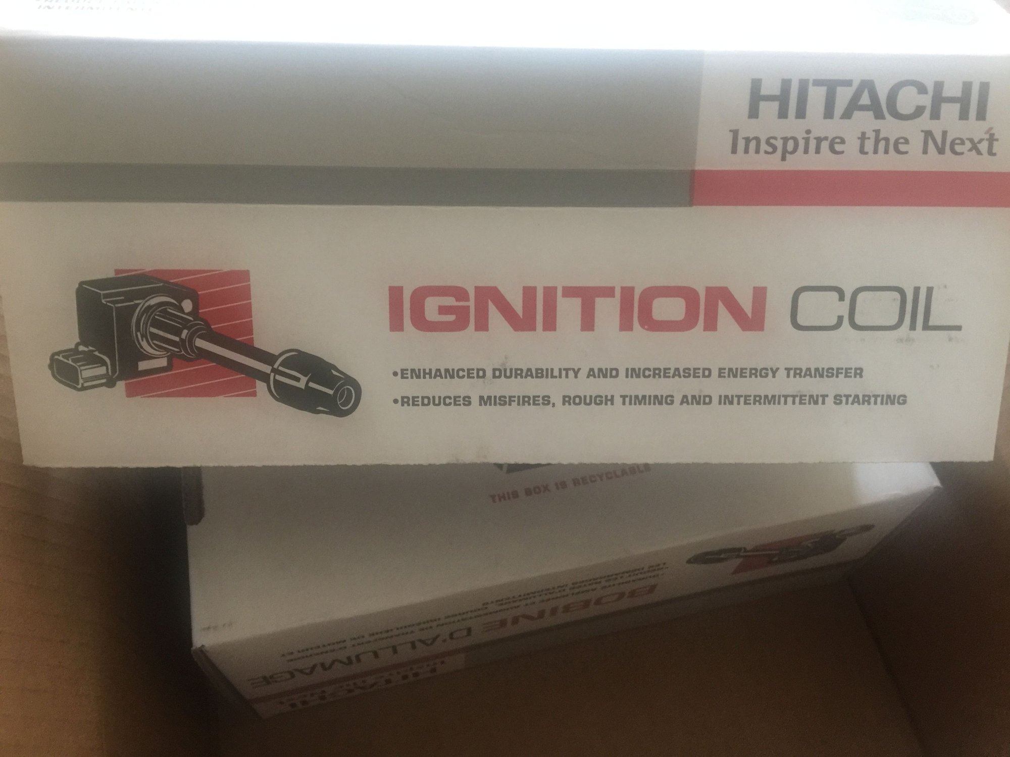

Well I didn't, I picked the car up today and paid the diagnostic only. Wasn't gonna do $1400 for dam coils.. I already ordered new hitachi coils and should be on its way. This has become a complete mess I know ....guess someone can learn my mistake when someone else comes across this problem.
I am not perfect but I make mistakes too.. That's how ya learn the hard way.
Anyway moving on and when the coils get here.. My mechanic is gonna replace them all for free. Then just call it a day.

Well they have arrived... Time to put them on. Crossing fingers.
Old Jun 12, 2016 | 06:00 PM
  #84
JoshG's Avatar
Joined: May 2013
Posts: 1,543
All of them were installed, found one coils rubber part was stuck inside one of the tubes, had to get it out.. Most of the junkyard ones were crap. Installed the hitachi coils.
Check engine light stayed off, and took it for a 3hour drive. No misfires, car runs so smooth now, and will report back in a week to confirm its gone. But it seems that it's all good now. It was just old coils.. Some of the rubber parts were cracked like hell.
Time to enjoy the ride again, more miles to go. Saved $1100 buying those Amazon coils. Thank you all so much, this is what the forums is all about, helping eachother out.
