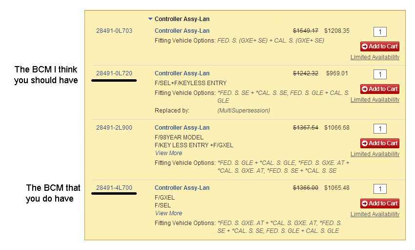

So all I can do is wonder if you have the correct BCM and if it is good. The part number for the body control module is 28491-0L720. See if you can find that number on the unit you got, it may not even be on there though. You may find other numbers that are like the plastic case numbers, but the first part (28491) indicates the complete assembly.

The parts book does not list the 28491-4L700 BCM as being for keyless entry. I don't think you have the correct BCM.

Well that wasnt it ... It was confirmed that the 28491-4L700 is keyless....just not mine or in my car. Im starting to think since my gxe is probably the lowest possible base model, that alot of wiring is missing. Giving up for now unless someone comes up with a breakthrough
