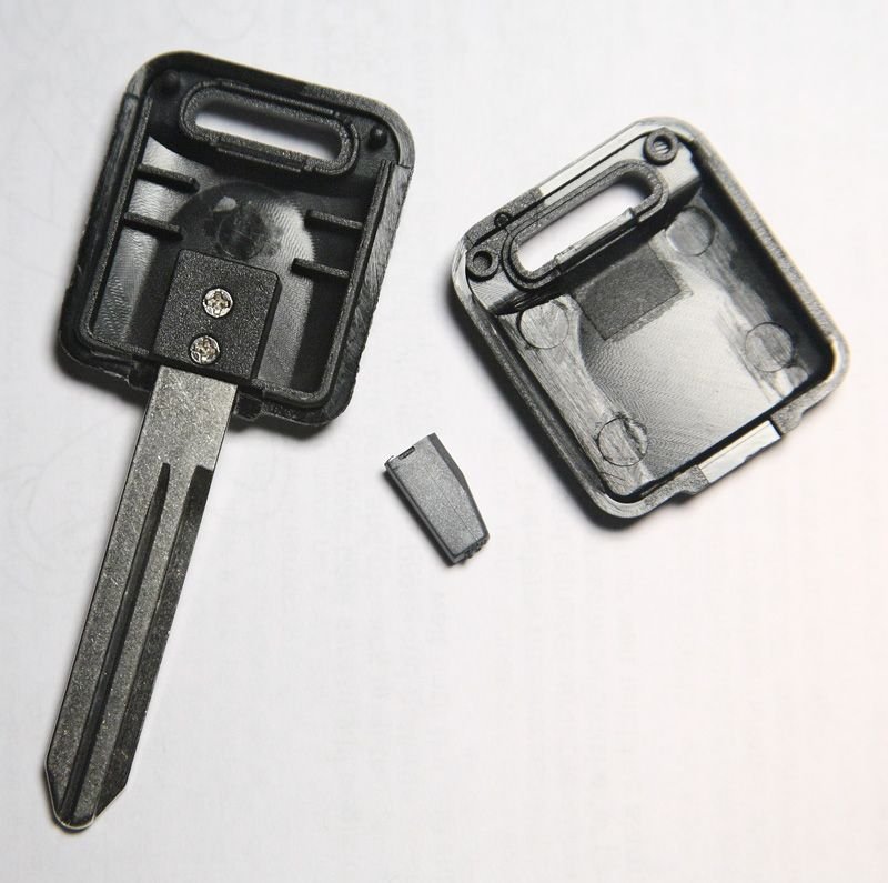

OK, here's what I bought on eBay. What's the procedure after I have the key physically cut at a locksmith? What's the gray pellet that came with it?

That's the chip.

So it's supposed to be put inside the key handle after programming? I don't see any electrical contacts on the chip. Is it programmed by wireless?

It's an RFID. Its ID is programmed to the ecu.

Just to be sure I understand how this all works...
The chips in the keys I bought online are already programmed. To use these keys, first I need to have them cut. Then I need to buy software, install it on my laptop, and use the laptop to program the ECU in the car to accept the keys.
The alternative is to take my existing key to Ace Hardware, and they can clone it for $75. Nothing needs to be done to the car itself.
Is this essentially correct?
yes
