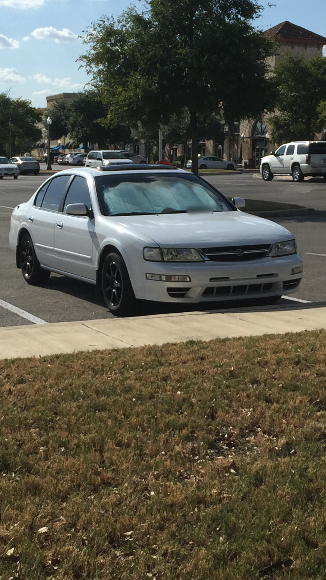

My little sister has been driving this car. We replaced the 1995 with a 1998 motor. Everything has been great for probably 3 years. Side note, I've probably spent 8 hours surfing these forums.
A few weeks ago my sister said she had trouble starting the car (nothing was happening). She said she also had idle problems in Drive and Reverse which was getting progressively worse. She also mentioned rarely that the car won't shift out of first gear. I replaced the starter which fixed the starting problem.
I then instructed her to bring the car to me so I can mess around with it. I pulled the codes and got a knock sensor code (replaced), 2 o2 sensor codes (replaced), improper shifting to 2nd gear (auto tranny), and some TPS sensor code I can't remember(replaced).
So I fixed all of those things and replaced ghe coil packs. We now have a excellent running car. The last issue is the shifting. Thanks to DBear, I replaced the tranny solenoids. The next day I drove the car out town to do some errands. She was purring like a kitten and shifting like butter, no problems.
My sister comes to pick up the car (temp has dropped at this point - a little chilly) and she starts it, then puts it in reverse and the car stops (along with my heart). I check the tranny fluid and notice it had bubbles. I drained some oil and the bubbles were gone, and now left with this issue.
I have spent probably 20+ hours fixing this car and $1k in parts. We just can't afford to get her a new car right now. So I'm reaching out to my maxima folks before I put it on craigslist or take it to the crusher. I'm so exhausted with this car. I also replaced the MAF and cleaned the IACV.
To summarize:
The car starts up just fine and idles fine, but if I put it in drive or reverse, it is like it's choking then dies quickly. Right after replacing the tranny solenoids, I forgot to plug the MAF back up and started it and it was doing the same thing that it is doing now (had a heart attack) then saw it was unplugged and plugged it back in. It then ran as I stated earlier just fine but today it's dying in reverse and drive (in gear basically). Would a misplacement (if that's possible) of the big spring in the valve assembly cause this? Do I need to drop it again and make sure all of the springs are in place?
