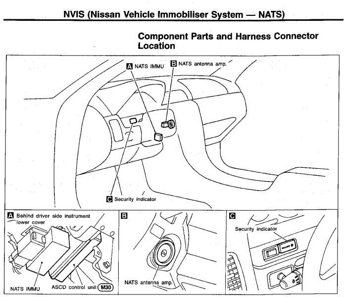

LOCK MODE FUNCTION
When the starting operation is carried out five or more
times consecutively under the following conditions, IVIS
(NATS) will shift the mode to one which prevents the
engine from being started.
- Unregistered ignition key is used.
- IMMU or ECM’s malfunctioning.
So what this is saying is that you can start these cars five times with a screw driver before it will lock down?
Also you wouldn't have a picture of the antennae amp as shown in picture B below would you? Having a visual image of the component may be helpful in locating it.

Sorry I don't have a picture. I try to put my NATS adventures out of my mind. LOL..
Don't be disappointed if the locksmith comes back and says, I just can't communicate with the ECU through the OBDII port. Many locksmiths have software that will reprogram a fully functional OBDII based system like the 5th gen and later.
Since the 99 model was the first year for NATS, and the 4th gen only provides minimal OBDII functionality, only a select few locksmiths have software that will communicate with the ECU via the 14 pin consult port. I've used a Consult like product named NDS2 to reprogram a 5th gen. However, NDS2 will not work on a 4th gen and NDS1 has no capability to reprogram NATS. So I make sure I have a spare chip key handy and remind the 99 model's drivers to never try to start the car with the drivers door open as a few unsuccessful starting attempts with the drivers door open seems to set off NATS and the car becomes immobilized. I've "been there and done that" once enough already.
