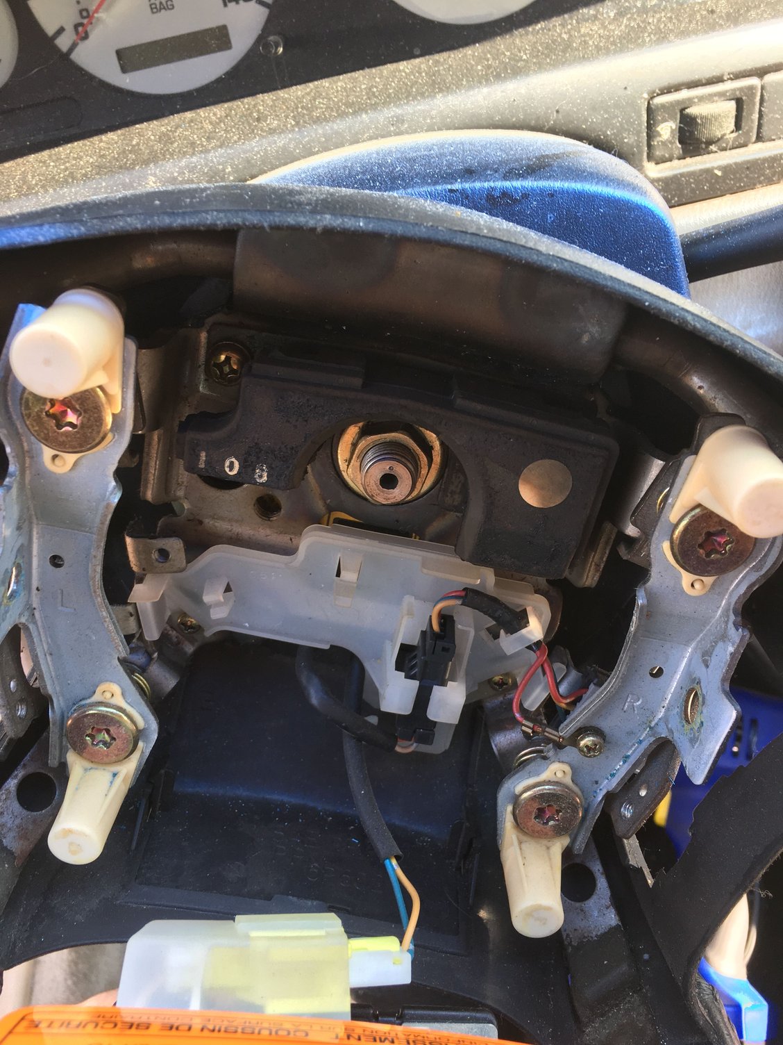

I see that that bar is laying on the stud cause the horn to blow .. probably one does plastic nub crack cause to lay on stud for the horn to blow .. well I got to disconnect the battery and wait 10 minutes for the air bag to be safe ? Get the o ring on the post .. just question with the fuse pulled it won't drain the battery right ?

Disconnect the battery and wait 10 minutes so the air bag will loose its residual charge.
Pulling the fuse to stop the horn from blowing will prevent the horn from draining the battery.

Wait the 10 minutes, then pull steering wheel air bag off. Disconnect air bag connection. Install O-rings or install new parts from jy car.

Well there's no cracks in the plastic and I can slide a credit card between were they make contact for horn to sound on all corners ... go figure hit horn and works as normal ... thanks for everyone's help
well took apart and all plastic intact no cracks nothing so I took a credit card and slide it wereshould make contact all is good on all corners go figure .. it's all together hit horn works as normal .. oh well thanks guys for all the help
