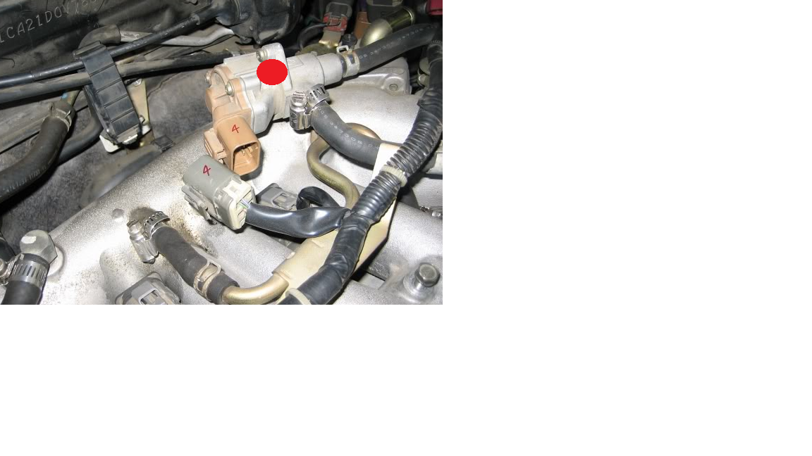

Here's a picture of one of the junk yard cars where I cut the line and found charcoal. From what you can see of the engine picture, this was not a horribly neglected car -- on the outside. I just think the evap system is misunderstood.
A new Intermotor evap canister for a 98 model can be purchased from RockAuto for $31.79. So for roughly 2x the cost of an air filter, you can avoid a messy charcoal headache.
Note that when I replaced the evap canister on the 98 model, I did not notice any charcoal. I found mud, but no charcoal. It was sometime and many $$$ parts later that I found the vacuum line was clogged with charcoal. The clogged line was the root cause of the returning evap code.

The line in the picture is the one that was full of charcoal and clogged up on the 98 model. So I removed the clamp and line from the service port connection and used 125 lbs of compressed air to clear the line. The other side of the line should be open before attempting to clear a clogged line. I guess if you want to add another filter, it would be for that line connects to the service port connection. Since the cost a new canister is so low for a 98 model, I would just replace it and keep the line setup stock.
In my case, the line was completely clogged. It must have been clogged for years. It took multiple tries with compressed air to eventually clear the line. It looked like about 1/2 a cup of charcoal granules sprayed from the line at the back of the car once I was able to break the clog loose. So charcoal had filled a large portion of the vacuum line.
The lesson learned from my evap code adventure below is:
Make sure the vacuum line from the service port (picture below) to the canister area is clear of a charcoal clog before replacing/servicing any other parts or installing a new canister.
I didn't see a mileage issue with my evap problem, so I can't give any advice in that area.

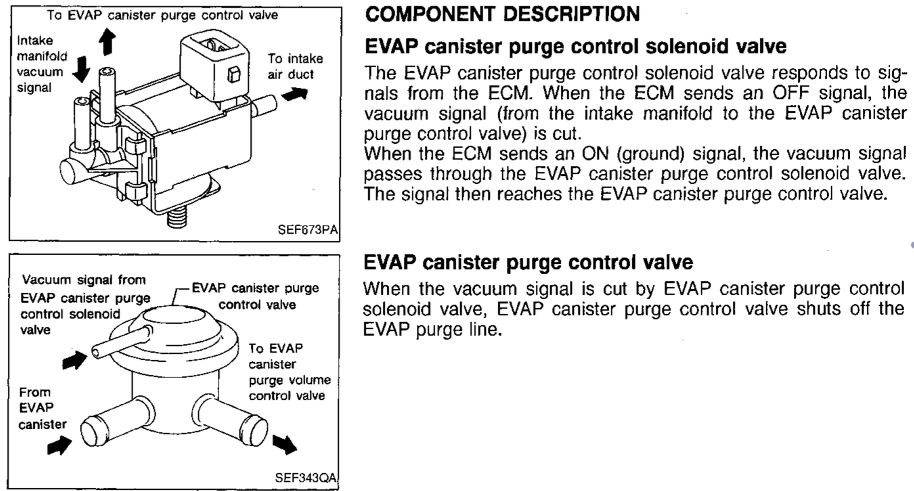

This seems strange, how can smoke in EVAP purge line make way into the intake?
Originally Posted by rbuswell
I bought a smoke machine and ran it on Sunday. There were no leaks.
As I mentioned I tried a smoke machine and the smoke would only come out of the intake leading to the air cleaner and the relief port out of the charcoal canister at the very back of the car. No indication of a leak from the canister itself or anywhere in the system.
The image of the valve - a vacuum-activated switch, normally closed (NC), until vacuum signal is present.
For testing for leak, would you have to close both ends of purge line while pumping in smoke? BTW the EVAP canister vent control valve is normally open (NO) until energized.
Attached Thumbnails Multiple DTC codes and gasoline vapor smell-screen-shot-2018-04-08-9.19.39-am.png

You may have replaced the evap canister purge volume control valve.
But 98FSM page EC-416 lists the cause of P1493 as: evap canister purge control valve device stuck open. That device was mentioned in earlier post by CS_AR
Originally Posted by CS_AR
Here is a section of evap purge line when ECM performs pressure and vacuum tests
Multiple DTC codes and gasoline vapor smell-p1493.png.
That device should be in close state when there is no vacuum signal, ie. engine not running.

This is exactly what I'm talking about ...
There are no uniform names for parts that have a very specific purpose. There should be universal name for this part just like a U-joint or brake rotor. The top picture you displayed appears to be this part:
They are very similar except yours doesn't appear to have a mounting bracket nor is it black. It is in fact the part I replaced. It has a Nissan part no. of 14930-3M201. It was referred to with about a half-dozen names when I first searched for it. Page FSM EC-368 also shows it as one possible source for the P1440. My parts invoice called it a purge control valve. The word Volume isn't included. It was also shown on several You.Tube videos on many different vehicles as the most likely source for my P1440 EVAP small vacuum leak code. Of course it also had numerous different names in the videos. I finally just took the leap and replaced it. When I did the P1440 small leak code went away as did the P1493. But the P1493 returned. Just as an aside, I have now driven the car another 400 miles approximately and the P1493 has not returned again. The P1440 never returned.
At this point, it appears you are telling me that I should also replace the pictured 14956-35U10:
It did pass the bench test recommended in the FSM. I'm beginning to doubt if any of the bench testing suggestions in the FSM are worth a damn.
Given how things have played out, it appears I had/have two problems. The small air leak P1440 was solved by replacing the first part and the P1493 will be solved by replacing the second. It threw me a loop when replacing the first part cleared both codes and they didn't come back for awhile. That combined with the similar names has made this enormously frustrating.

For me, I try to understand the role of a part. Let not forget a primary (simple) goal is purge vapor. The majority of the system is for diagnostic purposes.
Since vapor of unknown air/fuel ratio is fed directly to intake manifold it can screw up the ignition. Therefore ECM and all ignition sensors are involved, front heated o2, engine coolant temp, .... to assure a stable running engine.
The volume solenoid you replaced is to feed intake manifold (chamber with metered air) with gas vapor. This device has settings so that it can feed different vapor volume depending on engine running conditions, accel/decel/standing...
And the function of the solenoid, which you found good price, is to send vacuum signal to a valve to block or open the purge line.
