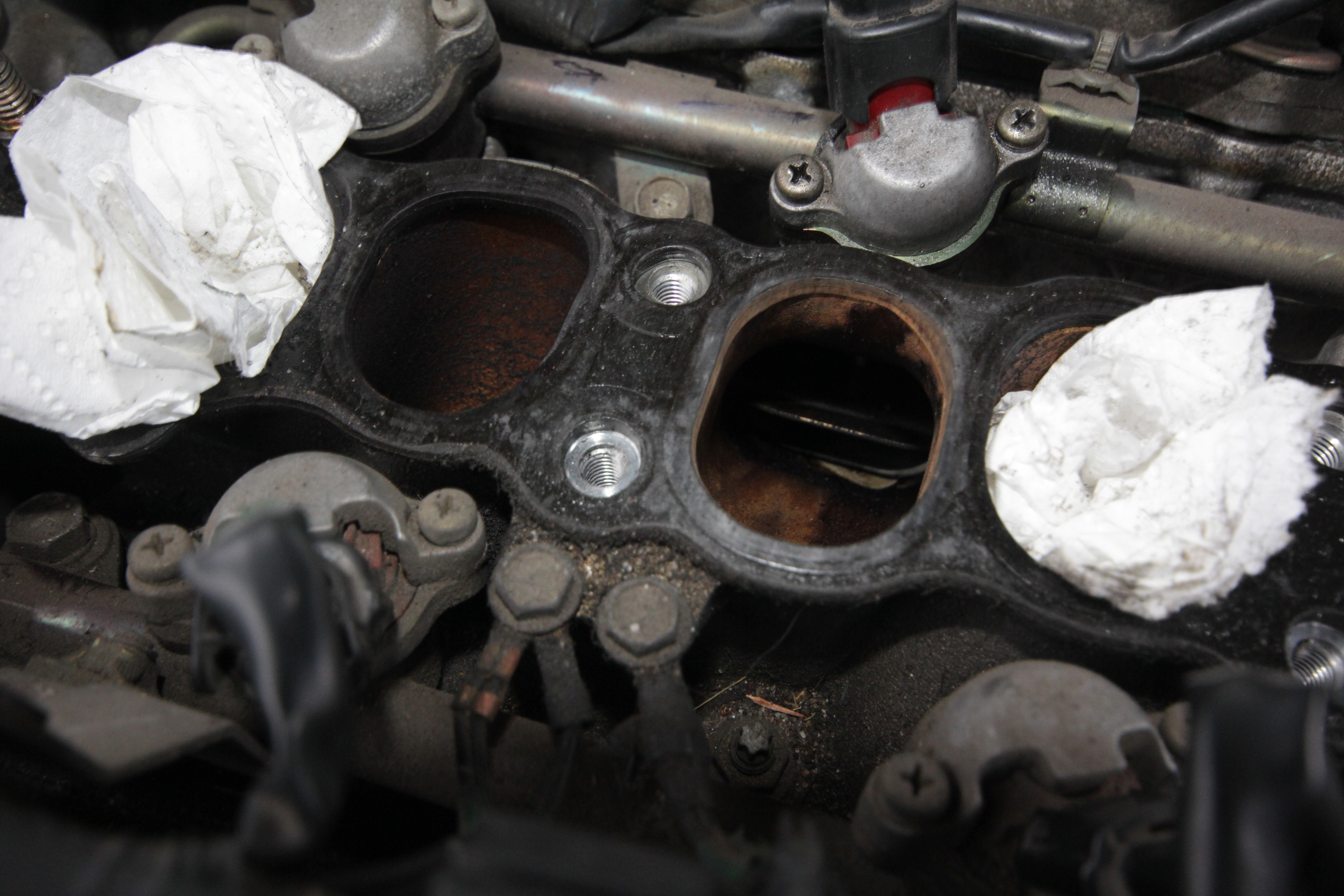

Hi!
New here - amateur at-home mechanic with some successful repairs under my belt.
Had a CEL and white exhaust coming out of a 99 Maxima (3.0 engine) - also smells like fuel and clearly running rough. Put the OBD on it and got a P0303. Tried swapping coils - misfire stayed on cylinder 3. Spark plugs were pretty old so I changed all 6. No change - still misfire on cylinder 3. The #3 coil electrical adapter/harness looked a little funky so I replaced that, too - no change.
Figured next place to check would be fuel injector. Why it had to be #3 god only knows - the only one that's completely hidden under the UIM....
Anyway, I got that off and on the outside the #3 injector looks okay. Ohmmeter gives me about 10.7 ohms (same on the other injectors) - so that seems fine (right?).
What I can see is that the #3 opening going down into the cylinders (not sure what that opening is called - one of openings the UIM covers up - the openings you gotta be careful not to drop a bolt into!) looks strikingly different from the other 5. The other 5 are pretty black and gunky whereas #3 looks bare and even a bit rusty (I attached some pics). The opening I am referring to is right beneath the (suspected) bad injector in the pictures - #3.
I'm suspecting maybe a bad O-ring or faulty/leaky injector - I'd like to take it out BUT (here is why I am posting here) - I totally spaced on draining the fuel rails before I got knee deep in this whole project....
Everything related to or touching the UIM is all hanging off disconnected - can anyone tell me if there is a safe way for me to drain/depressurize the fuel rail and remove the injector at this stage? If I have to put some things back together I will, of course, but man I'd really like to avoid that, if possible!
Thanks in advance for your help!

While you're back there, you might as well replace all three rear fuel injectors, and get the Hillman screws if you don't already have them. And replace the valve cover gaskets and clean out the EGR tube while you're under there.
Just because it looks OK doesn't mean it is. The issue can be from a bad seal, or some other non-electrical component of the injector gone wrong that would cause a problem but still give you the correct resistance on a ohmmeter.
Honestly, I wouldn't even worry about draining/depressurizing it. I actually forgot to do this when I replaced an injector. At least it was #4, in the front, so I didn't have to take the engine apart!
But you should still be able to simply pull the fuel pump fuse and (attempt to) start the car. Of course it won't start, but let it crank a few times.

Yes, you will need new screws for fastening the injectors in place, as almost all of Nissan's original screws strip too easily. The Hillman screws I'm talking about are these
The best injectors to get are one of these:
Bosch 62027
Hitachi FIJ0023
Beck/Arnley 158-0861
(all three are the actual OE injectors)
Also, the O-rings are sold separately. Get Beck/Arnley 158-0957. Each package of O-rings covers one injector, so you will need to buy three of them.
Yes, I mean both the big rear valve cover gasket *and* the intake plenum gasket. The best brands to get are wither Beck/Arnley, Mahle, or Victor Reinz. They are the actual OEM gaskets.
Correct. Just let it crank a few times with the fuse pulled should do the trick. The engine being disassembled shouldn't have any side effects since the car won't actually start anyway (engine won't be getting any fuel)
And even if you don't do it at all, there won't be too much fuel spilling out of injector #3 since the injector is no good anyway.
You might also consider replacing the fuel filter if you depressurize the fuel system. Get Bosch part #71650

Originally Posted by ilyaa
Perfect thanks again for detailed reply. One last question before I dig in: given the symptoms does the diagnosis of #3 injector seem accurate?
You have all the symptoms of a leaking injector.
As others have said, replace all 3 rear injectors.
Do the other while you are in there anyway things as well. Otherwise you will do everything again a 2nd or 3rd time.
in fact, if one injector starts leaking, the others will too. I would replace all 6 injectors. Rebuilt ones are fine.

alright - i think we're almost there - but not out of the woods yet!
replaced rear 3 injectors - no problems
replaced intake plenum gasket - old one was pretty dry and brittle
replaced fuel filter - no problems
replaced PCV valve (whoops - broke it when disassembling UIM)
rear valve cover gasket actually looked relatively new - it was the blue kind - still fairly rubbery and sealed quite well - did not replace that nor the rear spark plug seals - they seemed fine, too
cleaned EGR tube (externally - did not take it off - it did not look too bad - had some gunk around the opening but not clogged)
replaced valve cover to valve cover breather hose - old one was super cracked and hard
when putting back in the #3 ignition coil, the one of the poor, soft old screws broke - now half of it is left sticking in there - i tried my damndest to get it out but no luck - its screwed on with the rear screw and seems pretty snug, though
first time i turned car on, it was not getting a misfire, but i got a P0505 and a P1320 and the exhaust was pretty plume-y - although not nearly as bad as it was before
checked some connections and saw that a hose that i had re-hooked to the UIM was not on as well as it should have been - adjusted that - also realized i had not tightened the big airbox hose around where it hooks to the UIM quite snug enough - tightened that
ran the car again and it seemed to be getting better - checked that cylinder 3 was firing (unhooked coil-pack) and it was!! that was a good feeling -
now it seems to be idling fine (no visible exhaust) but i took it for a spin and:
1) it seemed to heat up kind of quickly - temp gauge only got to about 45% but i was only driving the car for about 10 minutes...
2) after the short drive the exhaust started to look a bit funky again - not nearly as bad as it was but not great
there is no CEL coming on - and the car feels fine (although maybe a bit shaky? hard to tell now that i am being super paranoid)
im wondering: should i replace the front 3 injectors? i only did the rear 3 so far -

All the injectors deteriorate at the same rate. The front ones should be rebuilt or replaced.
