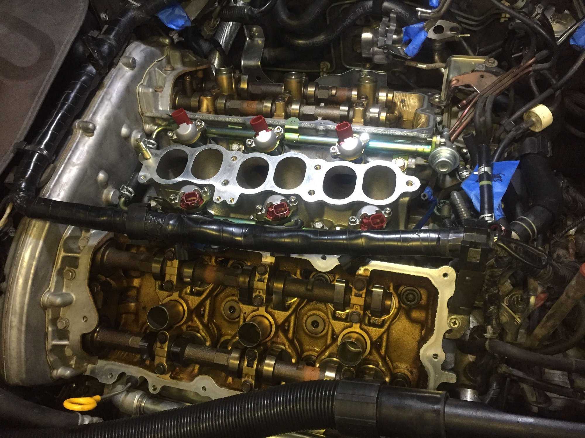

I got the upper plenum off.
I can now see lots of parts that will need replacing that I've previously only read about. I will keep looking for Part Numbers for these until I find them all:

Got the injectors out. 4 pintle caps and 6 o-rings in hand. 1 Pintle cap (#3) unaccounted for, and one fell down #2. Oh well - right?
The lower plenum is "right there for the taking", and everything around it is filthy. Am I making a mistake by NOT replacing that gasket (along with valve covers) at this time? Possible to screw something up with that that otherwise wouldn't be? I have to order more parts anyways...
I started poking around and discovered "phenolic spacers". Is that something I want to consider fo this daily driver?

The pintil cap for #3 might have caused the smoking condition.
Regarding the cap which you said fell into the engine, I'd say that it would get sucked through an intake valve. Since it's plastic, it will burn without casing issues.
I was concerned about dropping stuff into the lower intake manifold. So I taped it over while I was doing all the side projects which should be done at this time.

I finally got this put back together tonight - more than a month later. I did clean everything before reinstall - an extremely tedious process.
it runs well for sure
not leaking from above the oil pressure sender anymore
(still) leaking like a sob from front crank seal and/or half moons
i dont think any of the crankcase ventilation system was previously operational - all parts new now. Gotta change the pressure condition in the crankcase right? On top of the valve covers now being sealed.
I found a LOT of charcoal in the evap control valve and all the way up to the evap volume control valve...hopefully that will also fix the EVAP incomplete. Didnt get a ready out of 02, EVAP, or Catalyst during a short freeway test drive.
I took pictures, Ill post a few. THANK YOU to everyone who helped out w this and the other threads I started since on the way to completion here.
