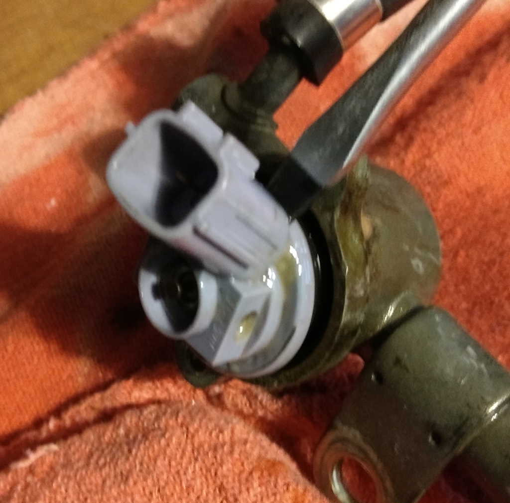

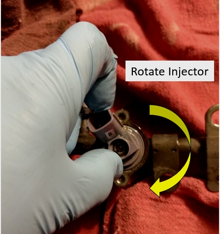

Welcome to the 4th gen injector replacement club. It doesn't sound like you'll continue driving it to destroy your cats. I spent a ton of money of replacing cooked cats and other issues that all started from two leaking injectors on a 99 model. After you get the injectors replaced, if the EGR still gives trouble, I've found that SMP Intermotor brand EGRs have the same Hitachi part numbers as OEM. the 99 models use an electric EGR that costs more than the vacuum type used on earlier models. You can save a lot of money on that part. When the EGR failed on my 99 model, it didn't throw a code in the beginning. The engine behaved like it had a vacuum leak at low speeds -- which it did.. If you have the tools and like like to DIY, you can save a lot of money.
Here's how troubled injectors look from a 99 model with roughly 165,000 miles.

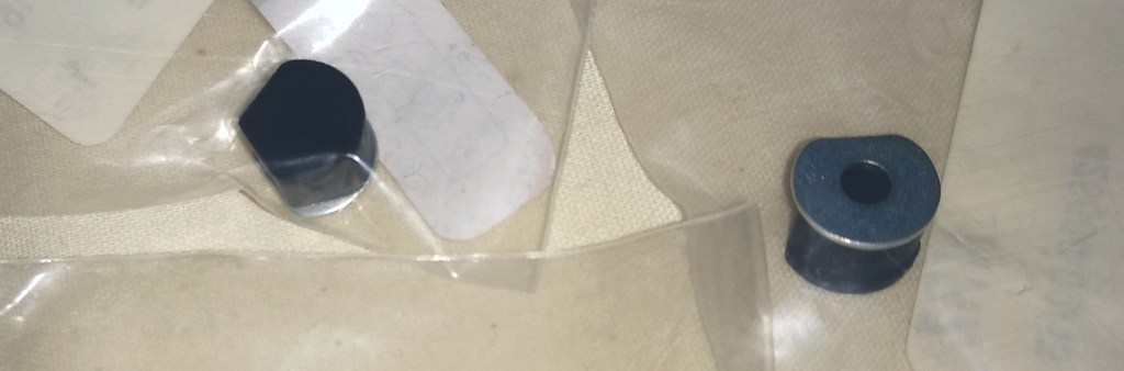

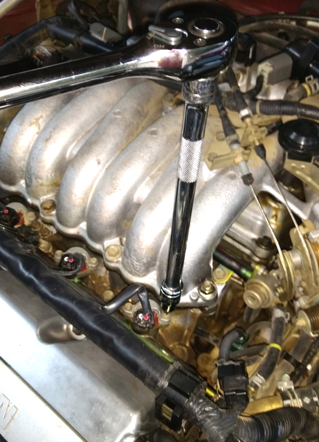

Broken fuel injector
I posted "gas pouring out of tailpipe" on 10-4-16. Well I finally got around to working on the car, and I found it is indeed a broken fuel injector. The front bank, right side of car injector is missing the cap off the end.
My question is, since the cap obviously got sucked down inside the motor, is there any way to try and retrieve it at this point ? Or do I just put a new injector in and hope for the best?
Old Oct 22, 2016 | 04:50 PM
maximaxi's Avatar
Joined: Mar 2010
Posts: 371
Don't worry about it. Just get a new injector, and you'll be ok.
The piece of cap will be caught by the fuel filter, which will prevent it from hurting your engine. If it was in any way a danger to your engine, you would've already encountered a problem by now.
Get a brand new injector. Bosch, Beck/Arnley, or Hitachi. Remember, they do not include the gaskets, so you'll have to buy them separately. The Beck/Arnley package contains all the gaskets (but each package is for only one injector).
And be glad it's from the front bank and not the back!

the fuel filter will not catch what is down stream from it.
the plastic bit already burnt up in the cylinder. no harm done.

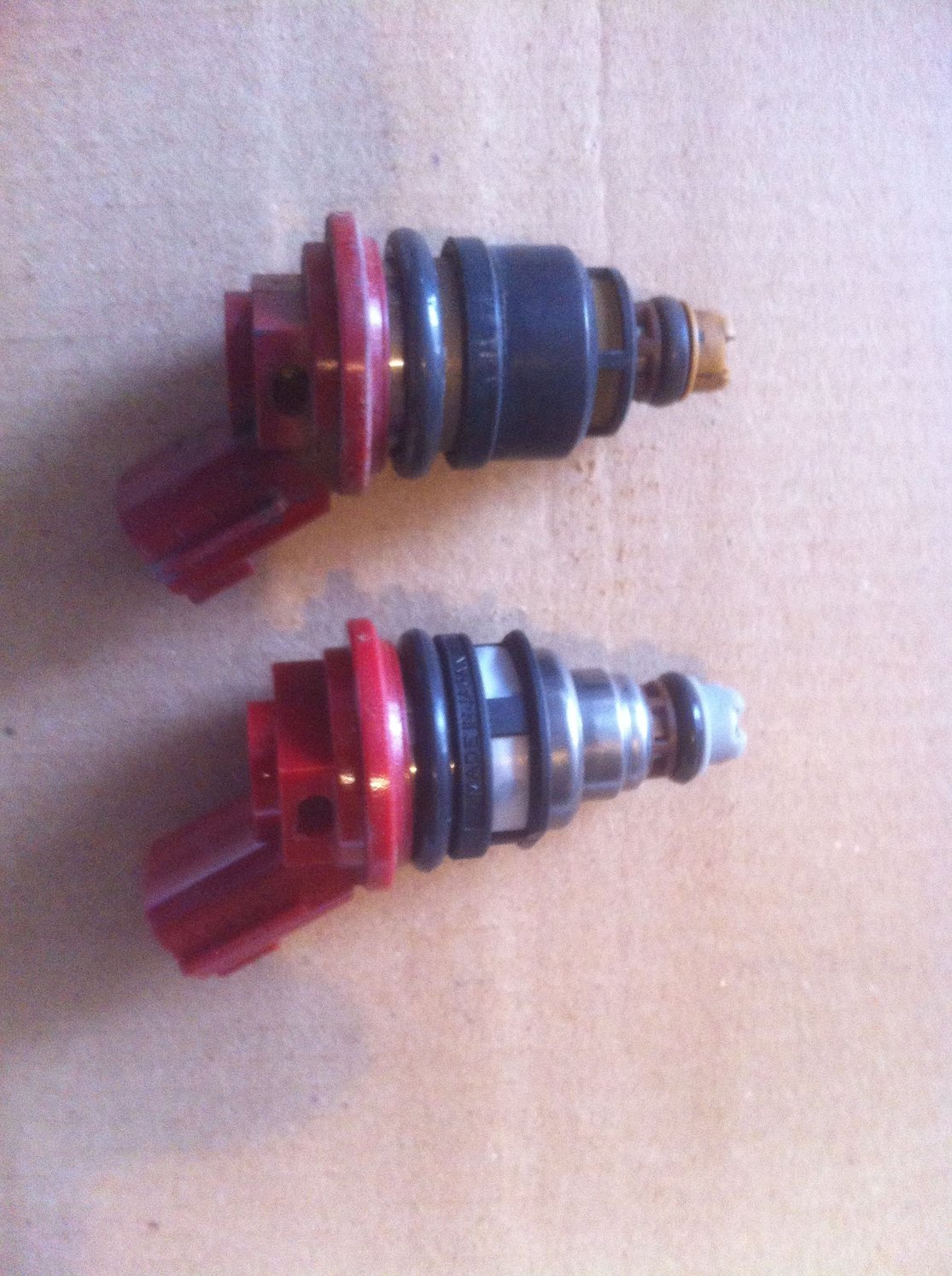

Rebuilt Injectors
I bought a set of 6 rebuilt injectors on e-bay for $80. They come with a 5 year warranty. They were advertised as A46-00, which should be the right ones for a 99 maxima. They look a little different than the originals, in the photo above the original is on top (if you look closely you can see the cracked cap) the rebuilt are below. Are these the right ones?
Looking online I see others for the 99 maxima that look like these, they are jecs

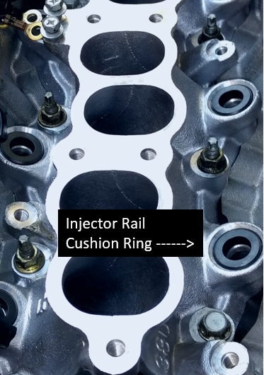

Also, if I'm just taking off the upper intake manifold to access the rear injectors, do I need a complete gasket set? I see I can just by the one separately.
Some of my injectors look like the top one, and others look like the bottom one. They work fine.
I couldn't get the uim gasket by itself at work so I just ordered the entire manifold gasket set. Just 3, and the thick rubber one is the uim one. Or you can go on courtesyparts.com and search gasket - intake manifold for your car. I'm sure there are also other sites you can find it by itself as well.

I had the same question a few years back. See post #6, here:
https://maxima.org/forums/4th-genera...injectors.html

Quick question, i have my injectors, i'll be putting them in sometime today or tomorrow but what about anything else? Should I be changing some other seal along with them? Because when i removed my fuel rail to put on nwp spacers i think it looked like there was another seal separate from the actual injectors

I replace the cushion rings as part of the job to hopefully keep from having to touch the rails again for many years. Though the last ones were fine.
On the last job, since the 98 model has the most miles of any of my 4th gens, I replaced the fuel lines between the rails and to the fuel filter. Though I did not replace fuel lines when I did the 99 model three years ago.
It would be a good time to replace the fuel filter if you haven't already done it.
Be sure to use some oil or lubricant on the o-rings so they will not get pinched on installation.

I spray a penetrating lubricant on the top of the injector and let it soak in to make removal easier.

Then I rotate the injector in the rail socket so the lubricant soaks in and coats the old o-rings to make removal easier.

After soaking, I turn the injector so the plug back is over a cap mount and use a screwdriver to pop the old injector out of the socket.

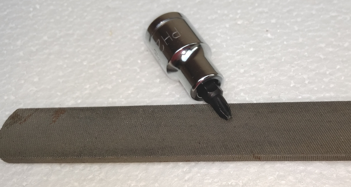

The Phillips looking screws that hold the caps on are a JIS type screw. If you get a 1/2 inch Phillips driver from Harbor Freight and file off the tip, you can make a JIS driver. If you have the rails out and have plenty of room to work, you might find using vice-grips on the screw head to break them loose will also work. I've done it both ways and found that making a JIS driver was the fastest way to remove the screws.

Then using a 1/2 drive ratchet with extension, I lean into the ratchet to apply weight to break the old screws loose from the rail without stripping out the heads.

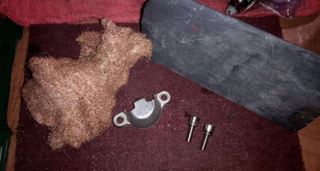

I replace the JIS screws with Hillman stainless socket head cap screws that I get a hardware store. Mostly because I don't like the JIS screws. If your old screws aren't mangled or stripped, then they should still work ok though.

Yupp the cushion rings were what i was talking about hopefully autozone has em. I did just order a k&n fuel filter when i noticed mine looked the same age as the car itself and i read something about a 5hp gain on the k&n high flow but i doubt that's accurate. i was able to break all of the screws loose besides one, which i still plan on trying to use vice grips on. what did you use to file down the phillips tip into a makeshift jis?

What did you use to file down the phillips tip into a makeshift jis?
The file in the picture.
I get Hillman Stainless Socket Head Screws from Lowe's or Ace Hardware. M5 (size) 0.8 (pitch) and 20mm (length) with M5 lock washers.
