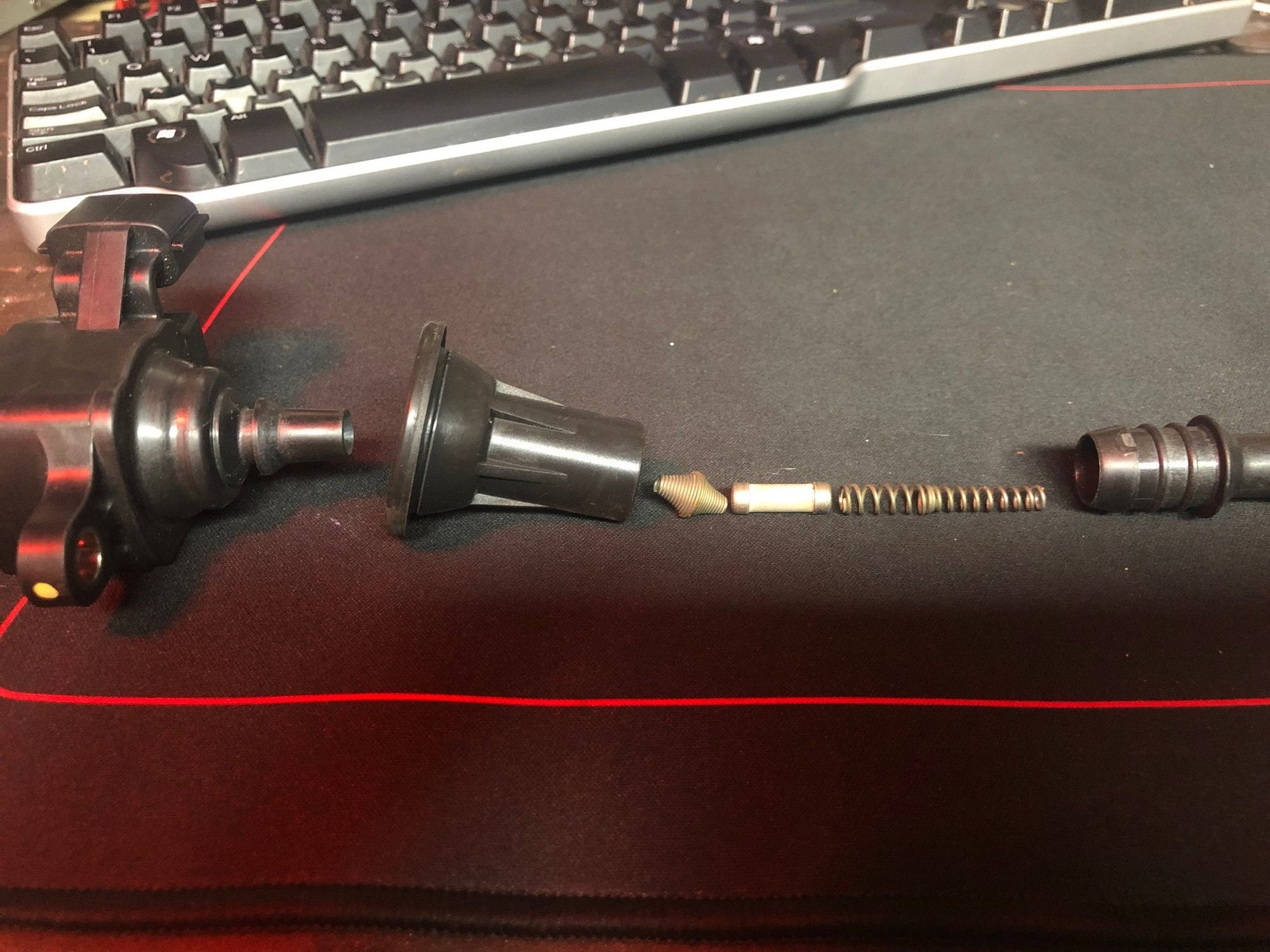

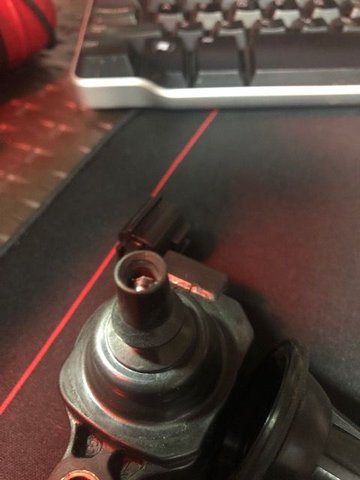

Cleaned up my OEM Ignition coils - 1999 - 2002 Maxima SE
Just sharing if it helps someone trying to address the pesky P300 misfire issues. While swapping out ignition coils - I opened up one of the bad ignition coil - and did very basic clean up job - and surprisingly it seems to have cleared the issue. See attached pictures for more details.
It goes without saying this is NOT a guaranteed solution - but it certainly saved me few $$$ once I did this simple clean up on the rest of the i.coils. Basically I opened the plastic boots that covered the internal springs, fuse and fuse contacts - brushed / cleaned the contact ends.
Cheers!
Disassembled 1999 - 2002 Nissan Maxima Ignition Coil.
