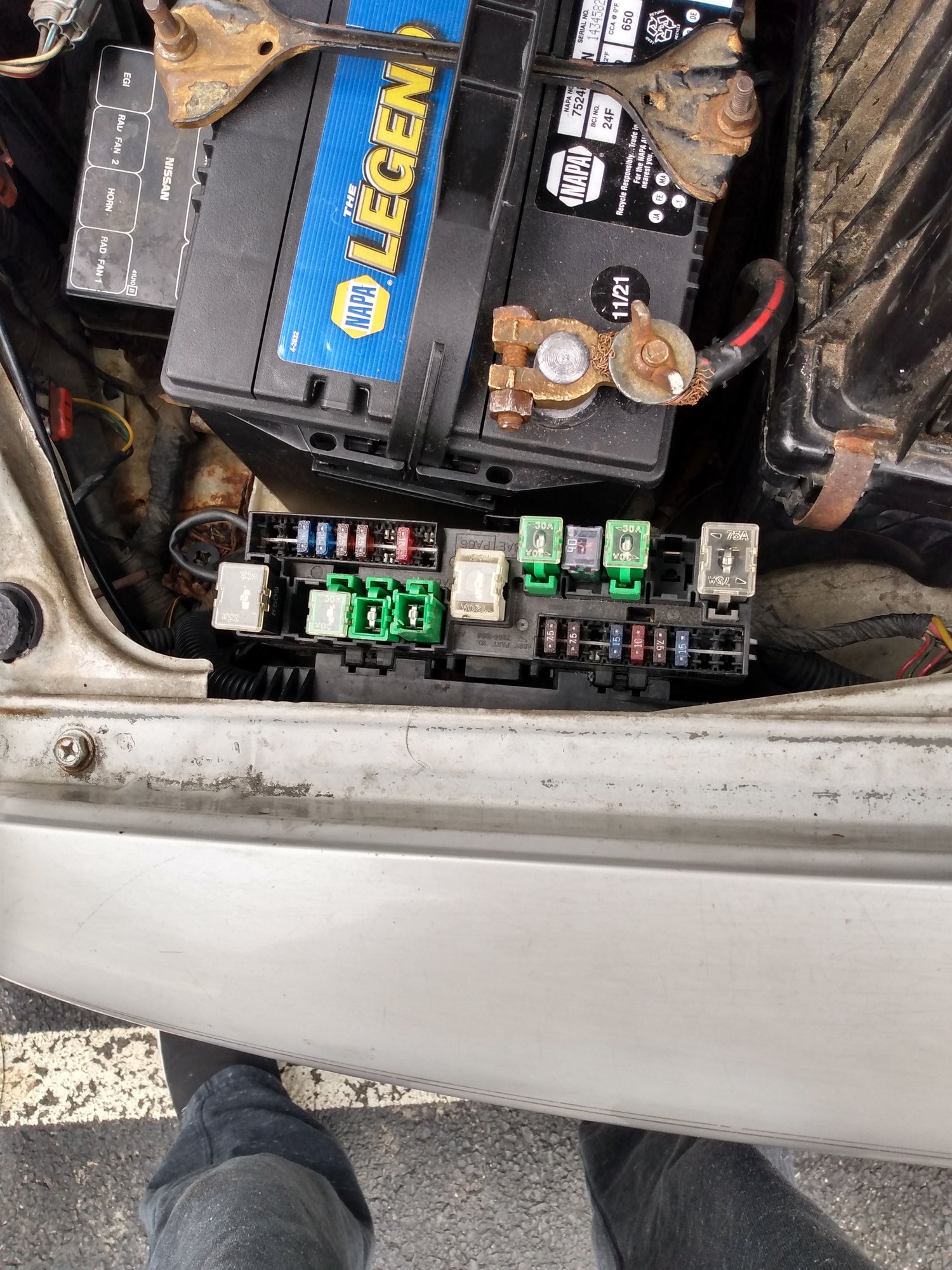

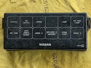

I just spent an hour taking out the antitheft fuses and relays and trying to start the car hoping it would somehow work and my dumbass still kind of believes you...
are you saying only the 99 will stop the car from starting if the antitheft is tripped or whatever?
theres also the inhibitor that might do something when the antitheft goes off...
Im just learning about this and recovering from illness so you could be right
but I mean the top pic is from the internet and the bottom two from my car the 7.5A fuse on the bottom of the top pic and the third blue relay on the bottom in the bottom pic are both labeled antitheft
