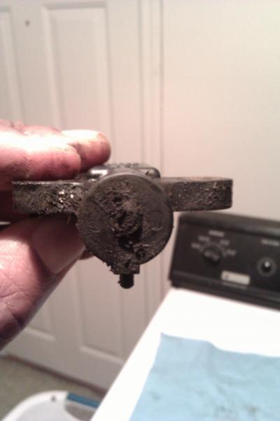

Update: So i got another starter and checked out the CKPS, its dirty and caked up with oil and dirt. I sparyed it down with CRC electrical parts cleaner and cleaned up the area by the oil pan. Tested the sensor with a meter and got (00.5) which is good. Reinstalled evergthing and check all the wire harnesses. Cleared codes and it was a success

But the pic u posted is the CKPS (pass side), usually its the tranny side CKPS thats fouled and causing hard starts.

The sensor in J2's picture is CPS(REF) which looks at the timing ring on the crank pulley.
CPS(POS) is on the transmission bell housing, under the car, and looks at the timing marks on the flywheel.
