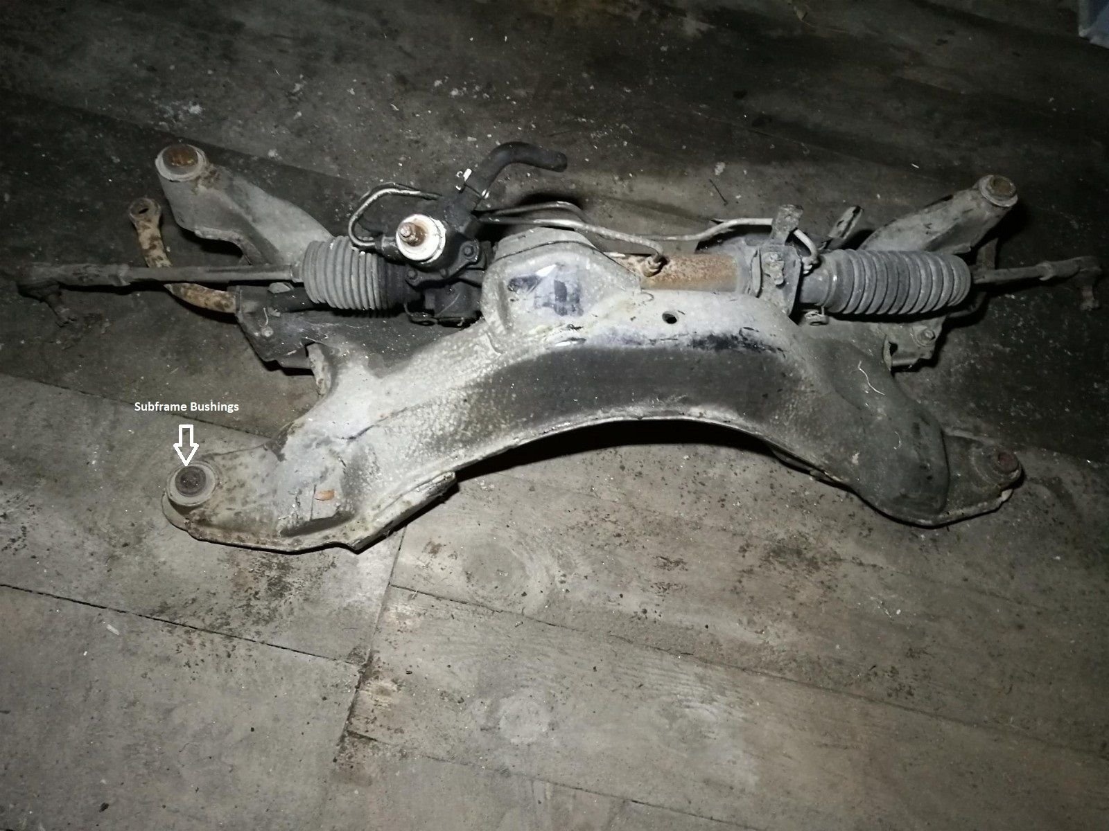

Hi.Is it possible to replace the Subframe Bushings from Underneath the car, without removing the "Subframe engine cradle" ?

It looks like the mounting bolts go through the bushings. So the only way to replace them is to drop the cradle far enough to remove and replace one side at a time.

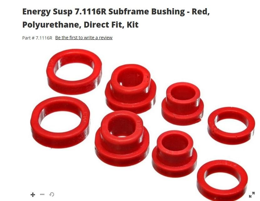

The energy suspension bushings you posted are for the crossmember that attaches to the subframe.
Right on! Different part of the suspension.
