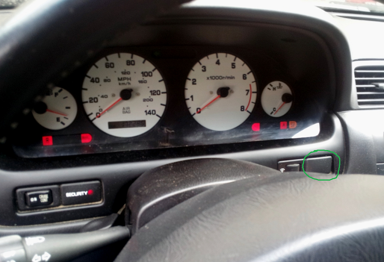

The blank dashboard button next to the dashlight level wheel is annoying me.
I note that it's blank because on the i30 it's for an electric fuel door opener switch.
Has anyone tried to retrofit that into a Max?
Mine's a 1996 GLE,
I'm guessing the door/actuator and the switch are easy, the wiring is where things would get interesting.

This is awesome, thank you for the insight.
As to your question "In the Infiniti, where is the button for the fuel door located?"
it is here (in a photo of a Maxima):
