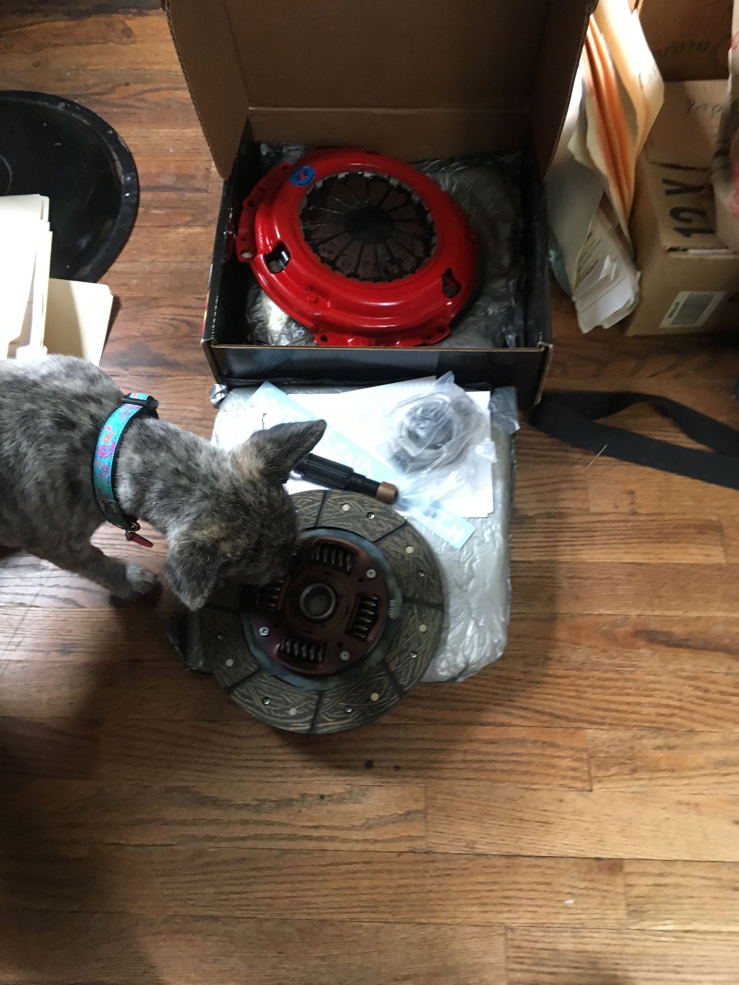

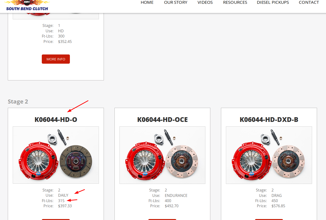

The South Bend Stage 2 clutch kit I got is the " K06044-HD-O" which is only one step and 15ft-lbs more than the stage 1 It's my understanding that South Bend achieves this simply by making the friction disk larger for the stage 2 HD-O while maintaining the same pressure plate used for the stage 1 kit. Result = more surface area for gripping = more torque capacity yet easy pedal feel. (stage 1 is 300 ft-lbs, stage 2-O is 315 ft-lbs. South Bend has 3 types of stage 2. I got the least aggressive one. Good for Daily driver, but a notch above stage 1. I figured this should be good for me since I run my car very hard and I need a clutch kit that can handle my abuse.
I installed a South Bend stage 2 HD-O in my 02 Dodge cummins and couldnt be happier. I mean really freaking happy. Worth every penny. The pedal is soo soft and effortless to push (easier than my VW tdi diesel) yet it absolutely grips and holds under severe abuse and ZERO chatter.
My son's dog approves of it, so it must be good.
