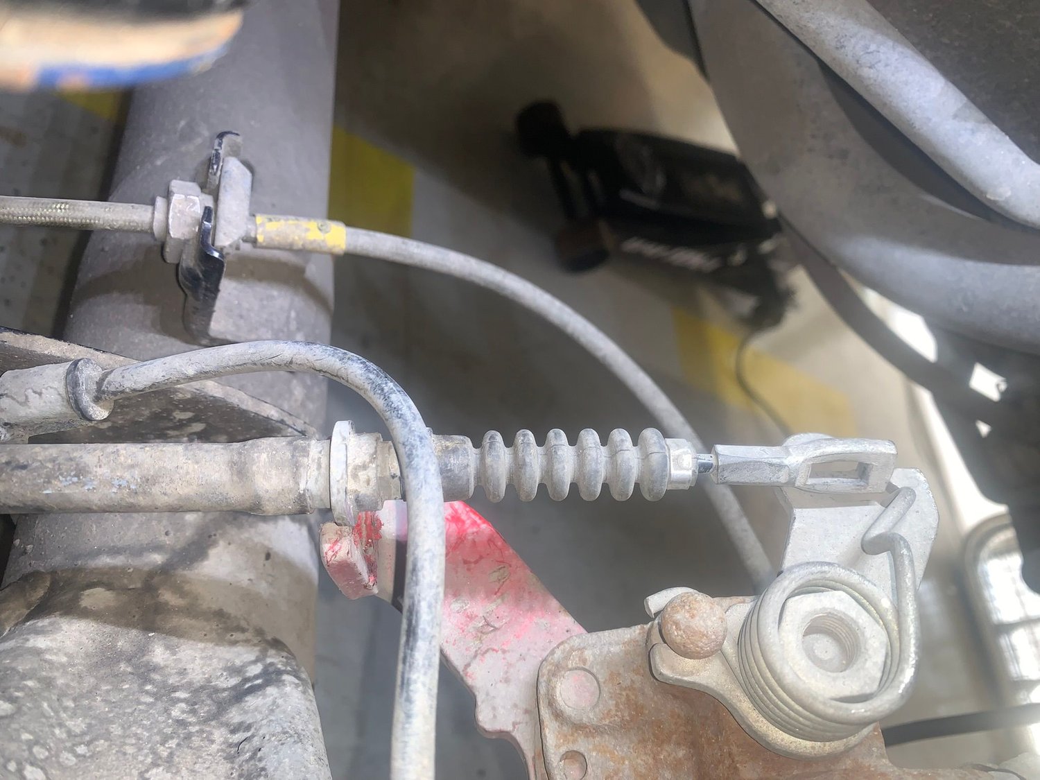

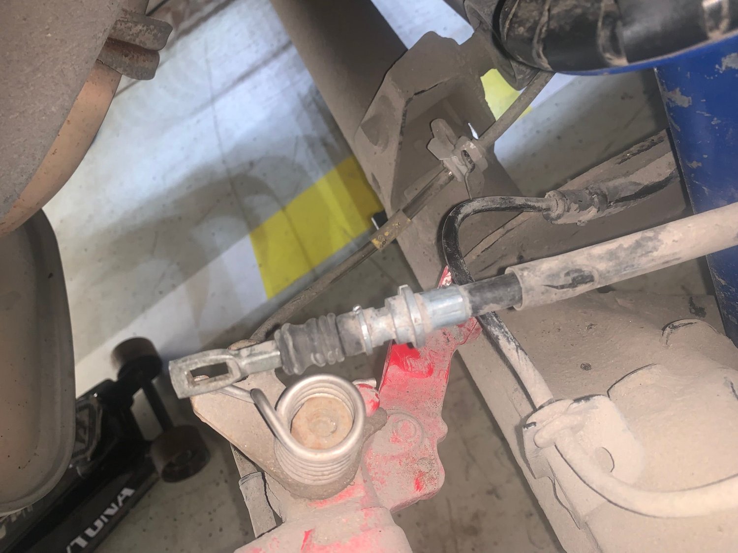

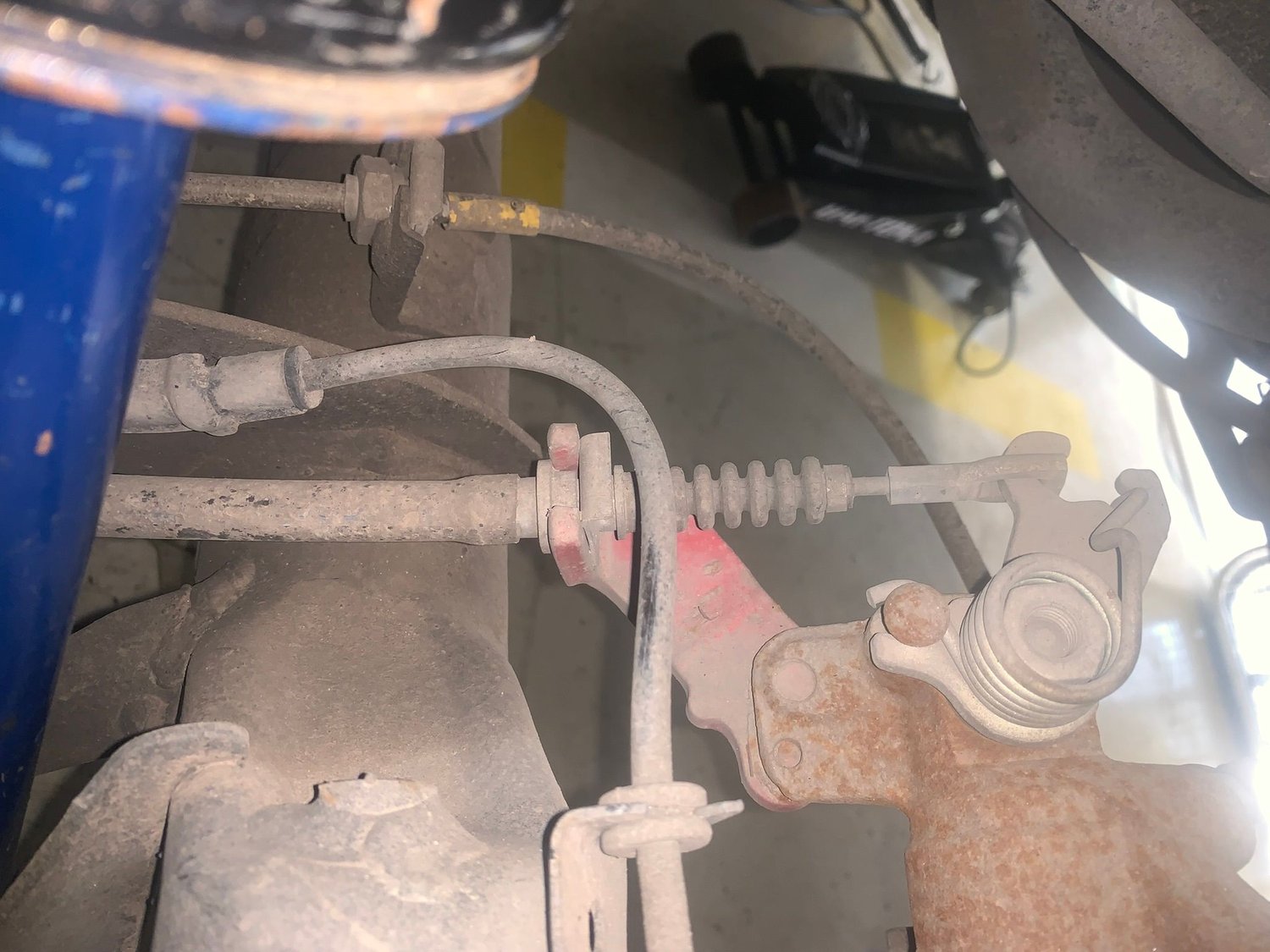

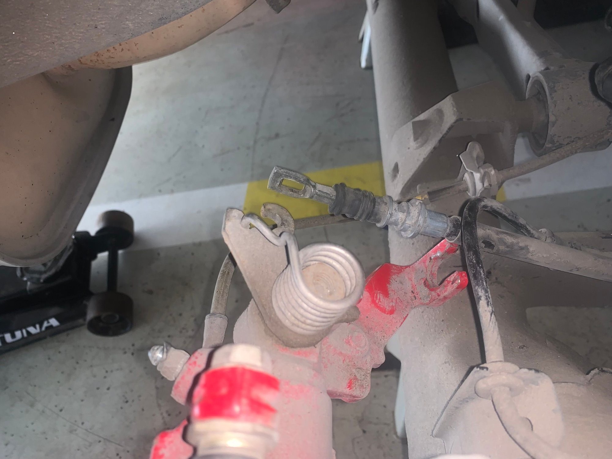

So...almost six years later: I've the replacement Nissan clip that secures the parking brake cable to the rear caliper (36406-01P0A). I'm trying to fix this issue on the rear passenger wheel, and I need help, please.
On the passenger side: there is not enough cable length between the cable's hook-end (that affixes to the caliper lever) and the end of the cable housing so as to clip the cable housing in the caliper bracket. See pictures below (apologies for the huge pics). I've tried using vise grips on the cable housing + screwdriver through through the hook-end to PULL the cable length needed through the cable housing, but without success (the cable appears to be seized inside its housing). The end of that cable housing is now so close to the cable end that it has crushed the rubber bellows into nothingness.
I've read a lot about this here on maxima.org (FSM doesn't mention required removal of two exhaust shields to service 2-to-1 cable bracket under the car, factory cables were prone to breakage, Nissan apparently discontinued the cables ~2017) and I want to know if its possible to fix this WITHOUT having to access the other side of the cable (requiring removal of the exhaust shields).
I've loosened the first attachment point for the passenger cable, removed the clip from the driver's side, and removed the interior console/brake handle. In the pics you see the handle is still secured to the cable - but there is excess cable slack sticking up from the floorboard that I cannot push any further back regardless of whether the handle is along for the ride or not (can't push a string).
The driver's side looks "normal", and the cable appears to move freely inside its housing.
Please let me know what you think of this predicament ("Can this be fixed without removing the exhaust shields?"). After writing this all out I think I know what the answer is ("jack that A32 to the sky and get after removing those shields") but I thought I'd check here first.

Drivers side still assembled
Driver's side still assembled
Passenger side, unhooked from caliper lever, with collapsed boot
Passenger side, note lack of length compared with photos of drivers side
Passenger side, note lack of length compared with photos of driver's side
Drivers side unhooked from caliper lever and housing un-clipped from caliper
Driver's side unhooked from caliper lever and housing un-clipped from caliper

Sep 19, 2025 | 07:53 AM
I can't imagine how you'd get to the fasteners or disconnect the long cable from the short cable without pulling the heat shields.
Sep 21, 2025 | 08:41 PM
Thanks. I've now done all the things and I have the passenger's side cable out of the car. It is "seized". The driver's side seems OK but I'm sure it's ghost is all ready to give up.
