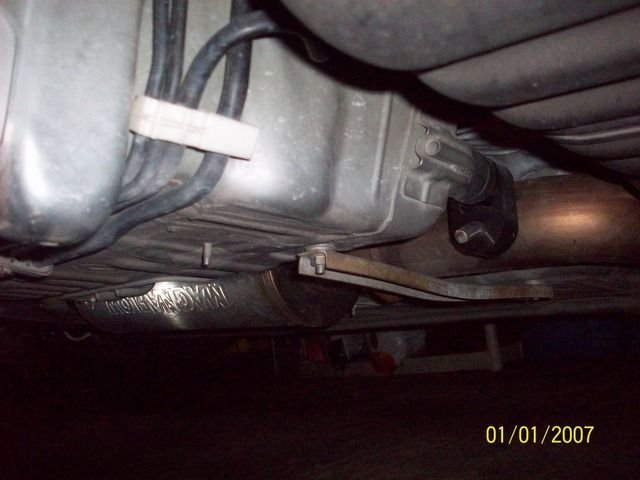

Here's my MES for my 98....

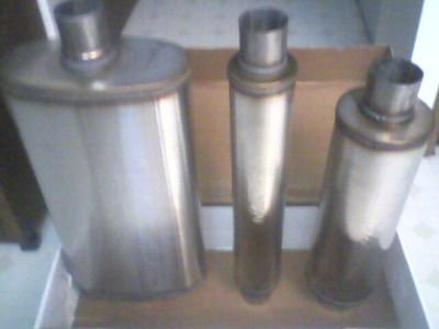

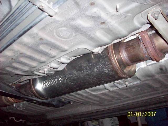

Here's a pic of The 3rd and 4th Gen Magnaflow mufflers I run (L to R)...Rear muffler 2.5" in/out (5" x 11" x 22"), Resonator 2.5" (4" round x 22"), Resonator to the far right was for my 5.5th Gen's 3" Cattman catback system. I wanted it a little quieter so I fabbed up a Magnaflow 3" in/out, (6" round x 18") muffler flanged it made it a bolt on modification. The name was the Carltonator. It dropped the sound decibels down by mid 20's - mid 30's. So I'm not against buying any performance exhaust and altering it for my needs. If that means buying a cheap eBay exhaust system and chopping off their cheap low quality mufflers/resonator and installing bigger higher quality mufflers and heavy duty hangars, It's easy as hell to do! The formula I use is basic math calculating the volume of each resonator till I find one that fits the space but offers 2-3 times as much volume! Most Maxima(s) can handle a 22" -24" long muffler body in the rear. The resonators usually are 18" -22" long and 4-6" round...14" rear mufflers are noisy as hell and I was taught and believe that biggest muffler you can fit under your car is want you want! I'm a Magnaflow believer because my1986.5 D21 Hardbody pick up had 6 Dynomax Super Turbo mufflers installed, then in 2000 I rebuilt that motor and installed headers, and a 2.25 catback with a Magnaflow 2.25" in/out 6" round x 14" long muffler that was still spottless, corrosion free in 2019 when I sold the Truck! Any Questions hit me up!

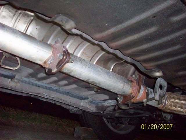

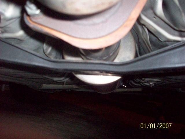

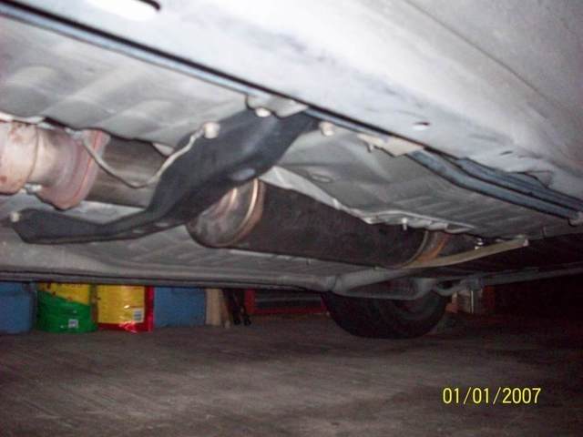

Here's the fitment of the Magnaflow 6" round x 18" resonator I fitted to my 5.5th Gen's 3" Cattman Catback exhaust system...Also this car is lowered on 1.75" drop Progress Tech Sport Springs and we don't rub on speed bumps nor steep driveways...

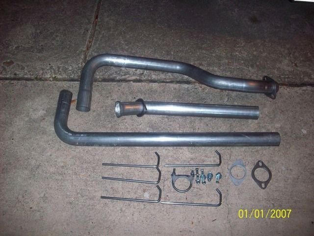

Here''s the MES tubing kit before I installed it! I've included the system the previous owner decided to fab up using a loud *** Flowmaster muffler and delete pipe it sounded like a Dump truck....I Fabbed in an old Cattman 2.5" resonator I had laying around and it still was loud as Funk! I'll advice you guys to steer clear of small mufflers they suck!
