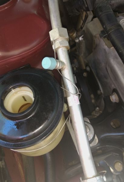

If you need to replace the tensioner on a 97-99 model, it can be done by only removing the tensioner cover.
Get the AC line out of the way.
Remove the 10mm bolts that hold the tensioner cover in place.
Remove the tensioner. Make sure you have slack in the chain at the tensioner point by slightly rotating the crank backward to relieve tension. Remove one tensioner bolt while leaving the other loose enough so you can rotate the tensioner to an angle so it can be removed without losing the plunger and spring down into the chain works. I keep my thumb on the plunger to keep it in place as I carefully rotate and pull the tensioner out.
Be sure to get the TSB gasket.
I made a guide pin that allowed me to hang the new tensioner on it to thread the other tensioner bolt. Without the guide pin, it is miserable to get the bolts started.
