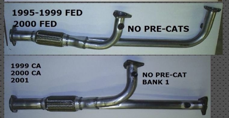

i did NOT lookup or confirm P/Ns, but this snip from the Warpspeed website appears to confirm the interchangeability of the ‘99 and the ‘00.

The 1999 Maxima Cali Spec has an exhaust manifold (radiator side) that has a much bigger outlet that wouldn't fit in the usual 3 bolt flange like the firewall bank. The pre-cat does the reducing to fit. Not sure what the answer would be whether a different exhaust manifold or an empty pre-cat.
As far as the pictures of 99 to 01 Y-Pipes. That's 4/99 and after, not before 3/99. Different length and setup altogether.
