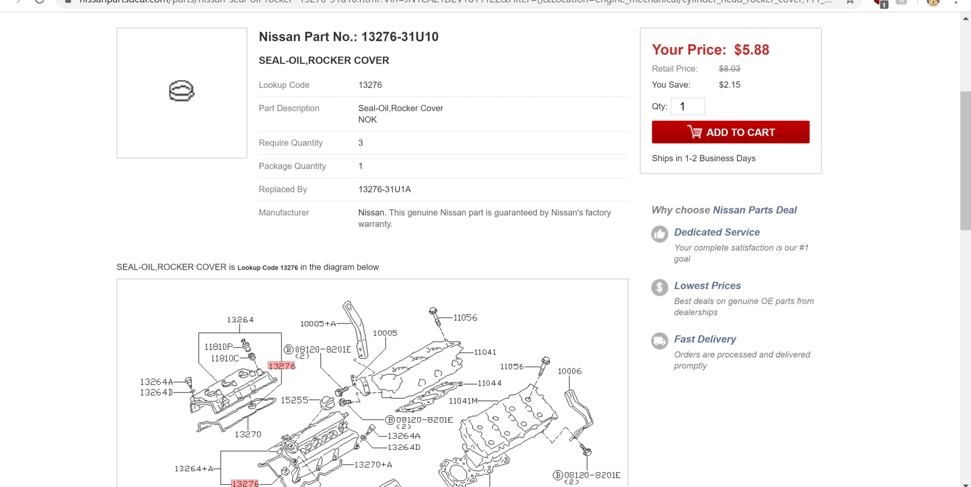

Yup there supposed to be different. Here are the images taken by part number and it states Quantity of 3 for each part number.

On Infinitipartsdeal, it states quantity of 6 for each part number, giving you 12 tube seals. And if they were truly different from front to rear, they both would not turn (yellow) highlighted when you click on one of them. I believe JvG is right when he said it’s an updated part with the old one still being available for sale.
