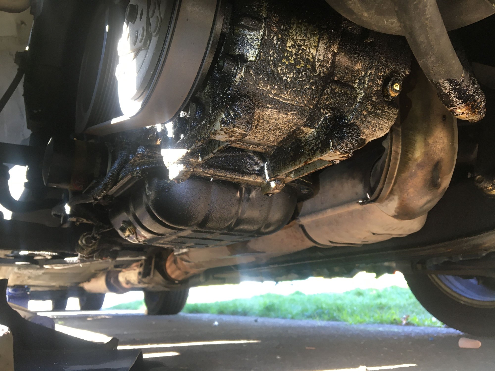

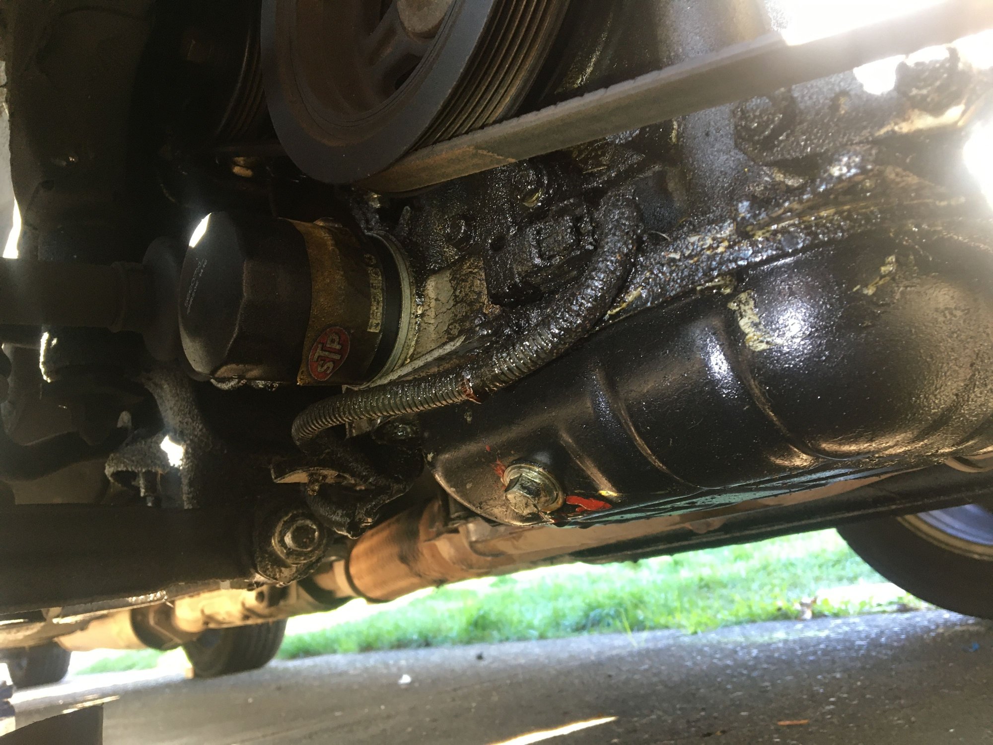

The oil was real low shortly after I did an oil change. Also, I’ve known about a small oil leak around the valve gaskets but it never was bad enough to read at a low level. Then about a month after changing the oil we had the fuel issue.
I might have put the oil filter on wrong. Or the valve gaskets got worse after the poor change. there’s oil all up and around the oil pan.
What could cause this leak? And would it prevent it from running if the oils is too low?

Possible places are a sensor O ring on that side if it's oily higher up.
if it appears to leak at the same height as the crank pully you will bed to remove the large pulley also called the harmonic balancer to change its seal.
