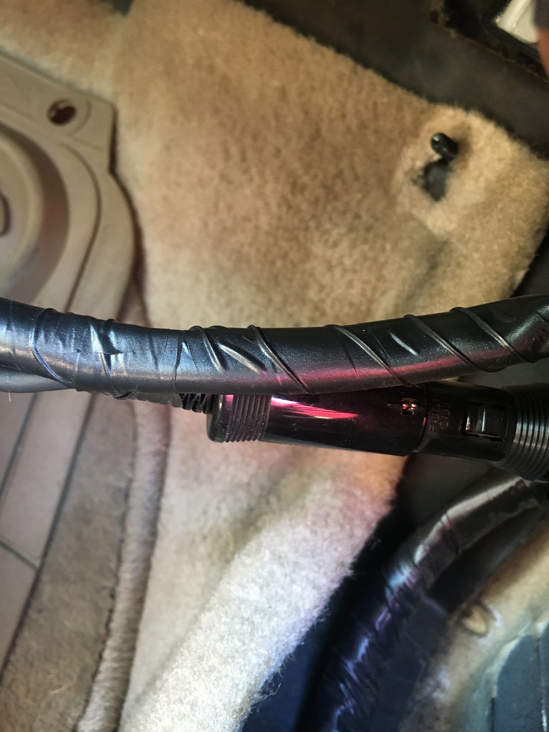

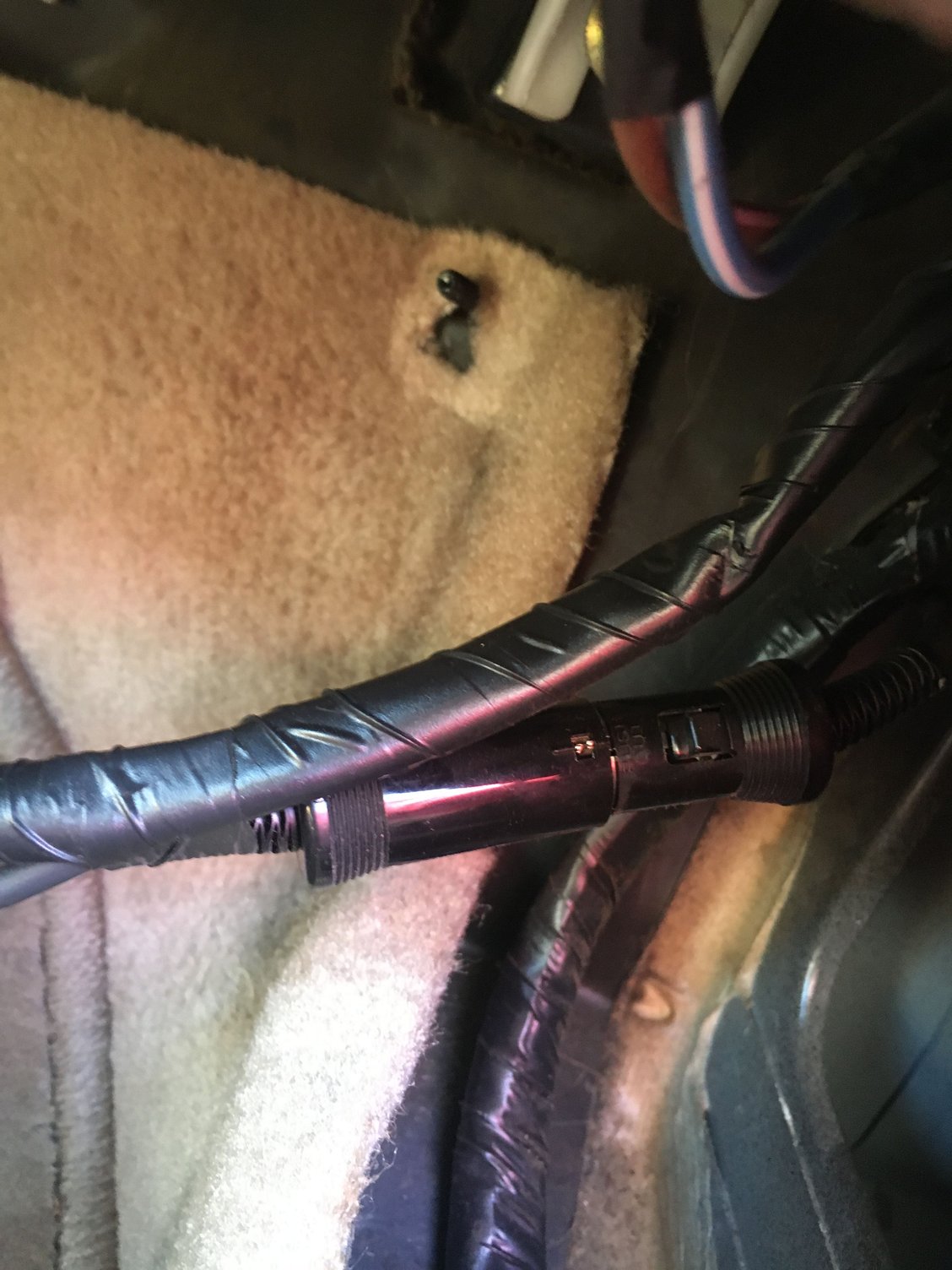

I did look in the same area in my i30 and it seems like it is the same case for me as I do not have that relay installed. However, there seems to be a taped up wire if you look up a little bit, similar to how the washer fluid indicator wire was taped up. I wasn't able to get the wire free, but it may be the wire for the relay, although I could be wrong. It is taped up a little bit up towards the glovebox if you follow those wires up towards the A-Pillar if you want to take a look.

I saw that on mine I havent checked the wire yet

Yes it was the correct wire thanks JSutter and others unfortunately before I checked for the connector I cut the wire and the rely side fell out, I am going to reattach it tomorrow, rookie mistake, I should have been a bit more careful but at least it can be fixed

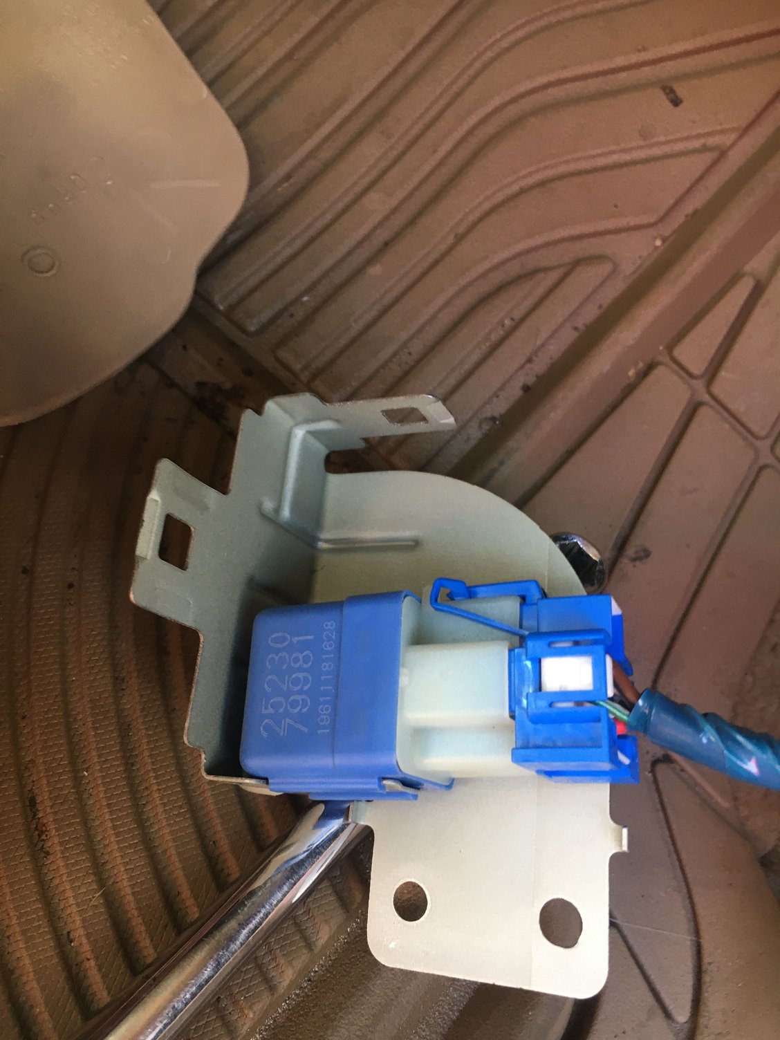

Got them working. as I said before I was stupid and cut the relay connector off. I had to remove the ac blower and the glove box so i could reach the cut wires and splice the connector back on. I am not proud of my electrical work because there was not enough room to solder the wires so I used cheep wire nuts, but hey it works and now I have heated mirrors for the raining Pacific Northwest weather.

Yes there should be 2 connectors behind the door panel one grey for the mirror controls and a brown for the heated part. Then you need to stick a blue rely in the connector taped up by the Ac blower behind the glovebox.and yes the mirror defogger is controlled by the rear defogger switch once the relay is installed you will here it click when you press that button

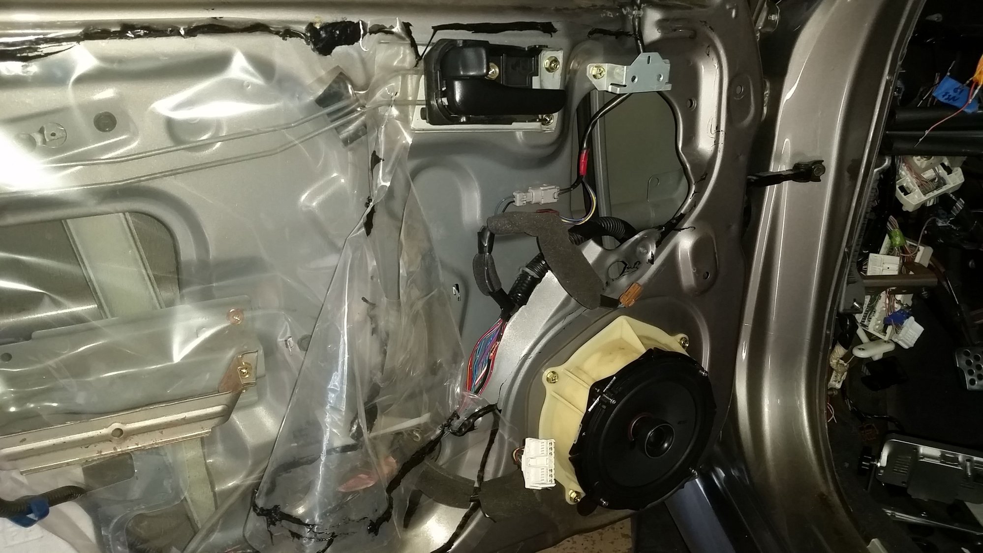

It's easy if you can grab the wires from a donor car. Just need to fish one wire to the main connector of the door harness and splice in a ground.
Not much to see. I added the grey connector. If you can't get the OE plug, one wire goes to the defroster wire at the kick panel. The other is a ground.
