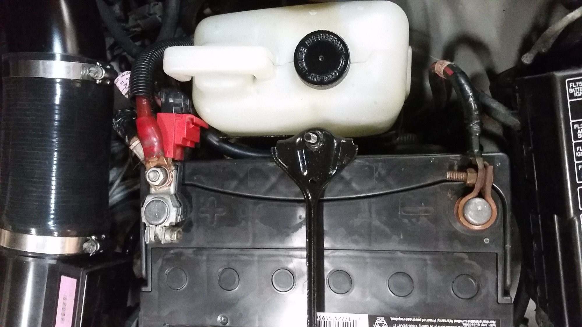

Modded stock stuff (big red wire is for stero).

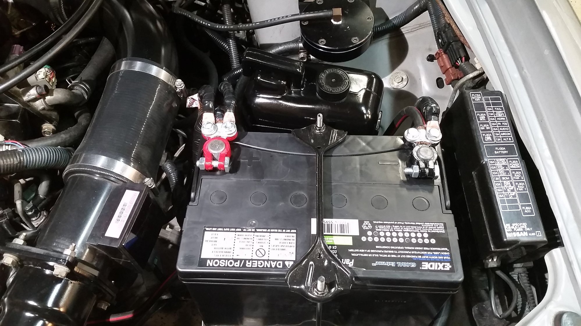

Generic terminals and rings.

Thank you for the picture I really appreciate it. It really helps me out since I'm completely new to this kind of thing. So if I can save the fusable link I can just turn it around and put it through the bolt then tighten it with the nut? As far as the black wire go, so I must cut it to fit onto the new terminal right? What do you call the thing with the sleeve that covers the exposed wires and goes to a circle piece that bolts down with the nut? Can you list all the parts I need to do this? I'm new to this so I want to make sure I know what I'm doing before cutting the wire.

Technically, there's nothing special needed for the generic terminals. Just strip the insulation back to clean wire and clamp into the new terminal. You could also stuff the smaller positive wires in there too if the fusible link is not worth saving.
I like to use copper ring lugs, just a matter of preference, and I have a few more wires added as well. I have used different sizes depending on what I had on hand or what I could get in a pinch. The 2 smaller wires go to the fuse box, they are around 8-10 gauge I think. You can group them together into one lug (4 gauge) or keep them separate (two 8 gauge lugs). The size of the hole is also dependent on the terminal used. The first pic (newer Nissan terminal) is probably 5/16" and the other red one is 1/4".
