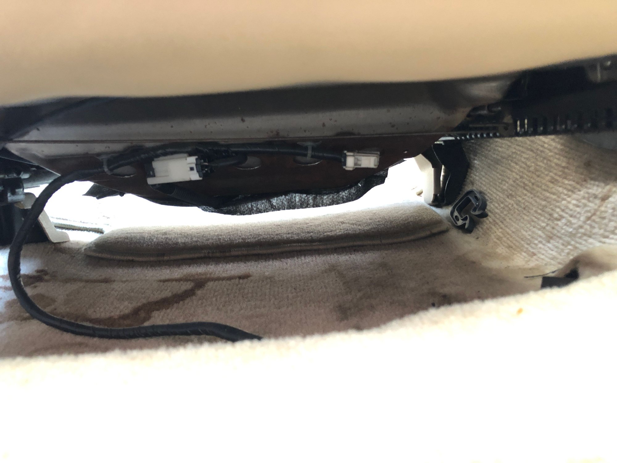

Ok so I went under my passenger seat and I see 2 connectors. The connector on the left is connected. I believe it’s for the heated seat. The second connector on the right is not connected to anything. Is this the connector that connects to the power motor for the power seat? I’ve attached a picture.

The passenger seat was not available as a power seat until the 1996 model year.
Old Oct 3, 2020 | 09:40 PM
Looks like you have the proper connectors. I say go for it.
