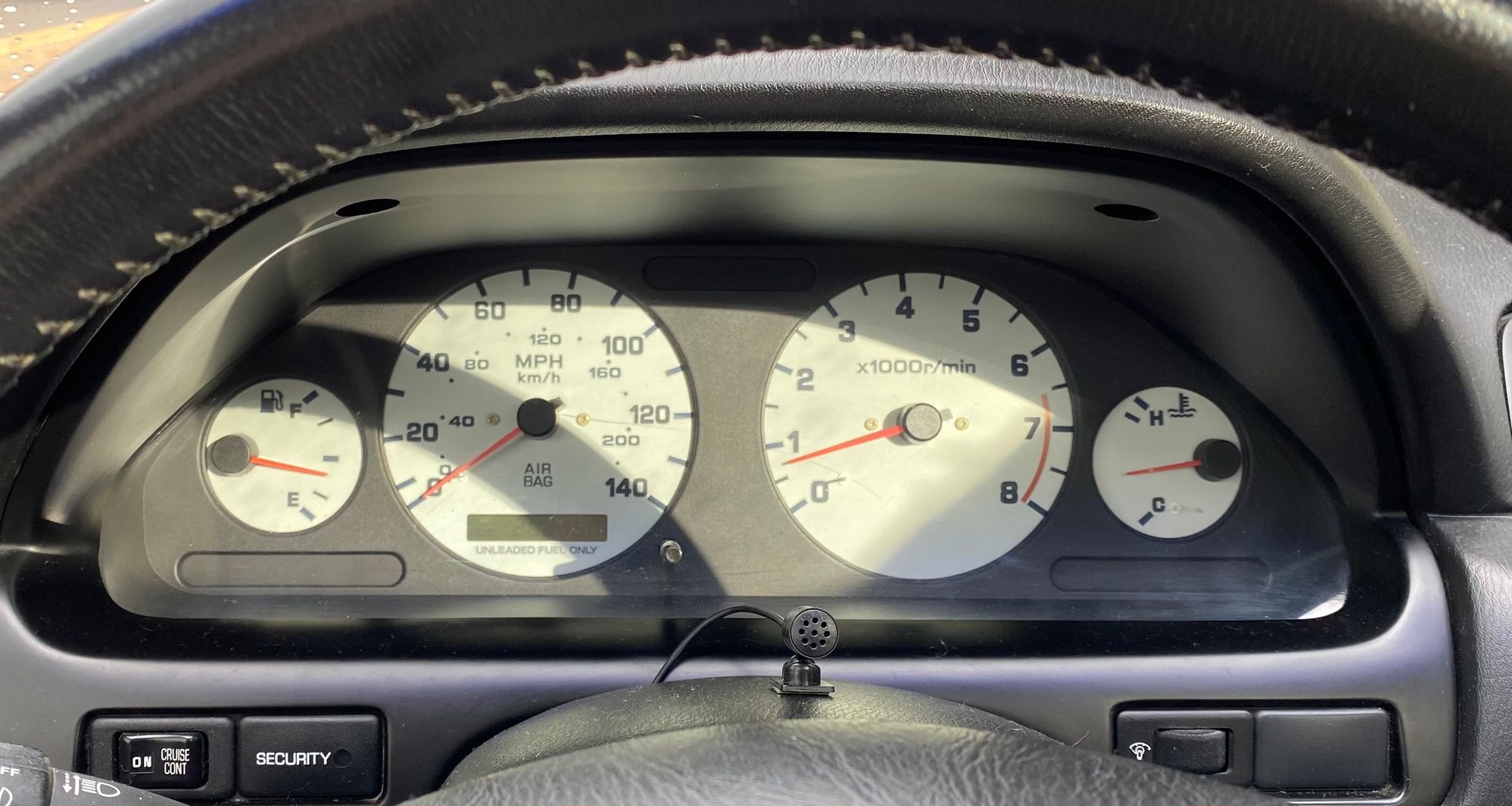

Here is a pic of the odometer in the daylight. Maybe this will help visualize the issue.

My radio lcd acted like this before it went permanent blank. I think the component is failing due to age.
Old Nov 19, 2020 | 08:16 PM
komik's Avatar
Joined: Jan 2008
Posts: 268
From: Dallas, TX
If it returns to normal occasionally, then it sounds like a bad / loose connection somewhere. If you're handy with a soldering iron it might be worth poking around and tightening up some of the connections as Rit suggested. The MAF related CEL codes on our cars are generally the result of cracked solder joints, so I wouldn't be surprised to learn the instrument cluster suffers from the same.
I am surprised to see orange gauge needles on an SE. I assumed they were all silver like my '96. If you can't fix your cluster maybe you could swap for an older one and roll it to match your mileage, plus you would gain the silver needles! (but I have no idea if they are direct swaps from a 96 to a 98, so don't take my word for it.)
