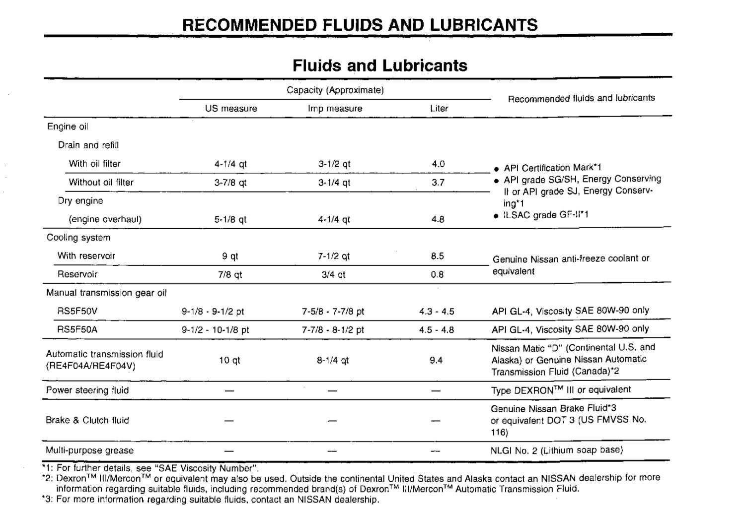

Nissan has the power steering fluid for sale and you can buy that or use the Nissan trans auto D-matic for the power steering.
