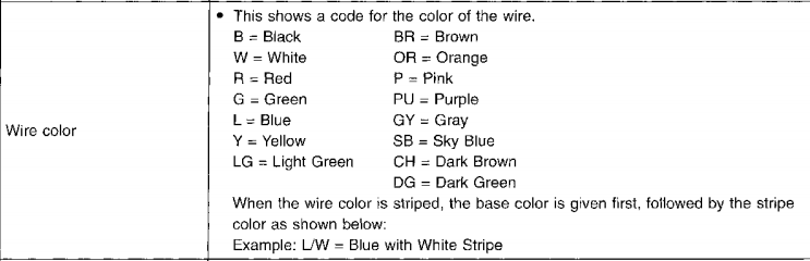

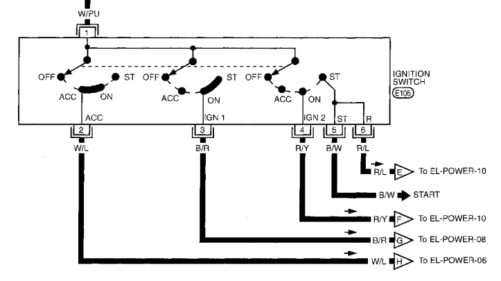

The light itself is insignificant, but there must be a reed switch or something inside the ignition that tells the BCM the key is inserted in order to initiate the programming process. I looked through the FSM to try to identify the part, or at least the wires connected to it to jump together, but I found no mention of it. The ignition switch section only addresses the wires related to the ACC, On, and Start positions. I looked through the Multi Remote Control section and found nothing there either.
If you decide to dig in to the steering column and find more wires to the ignition switch than the ones specifically shown below, those may be the ones you need.
