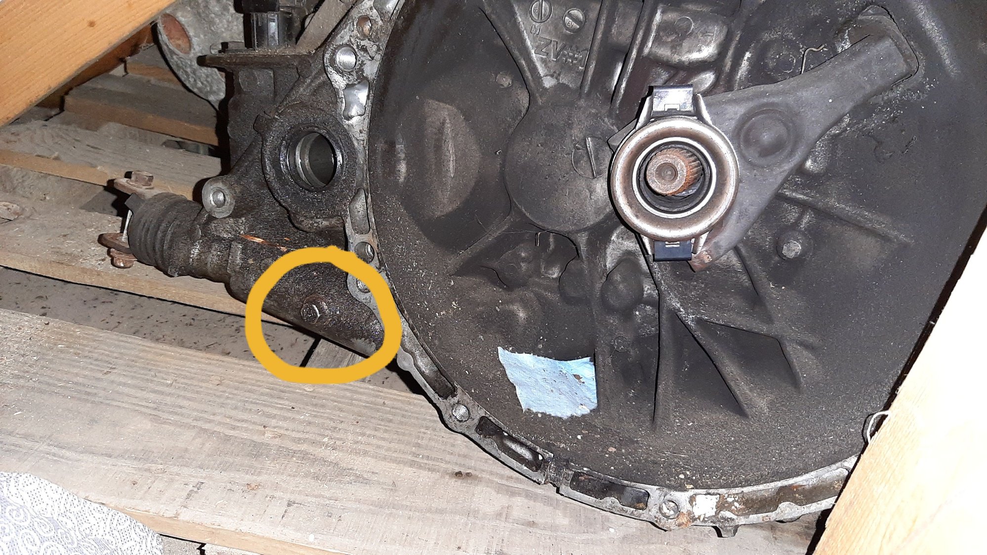

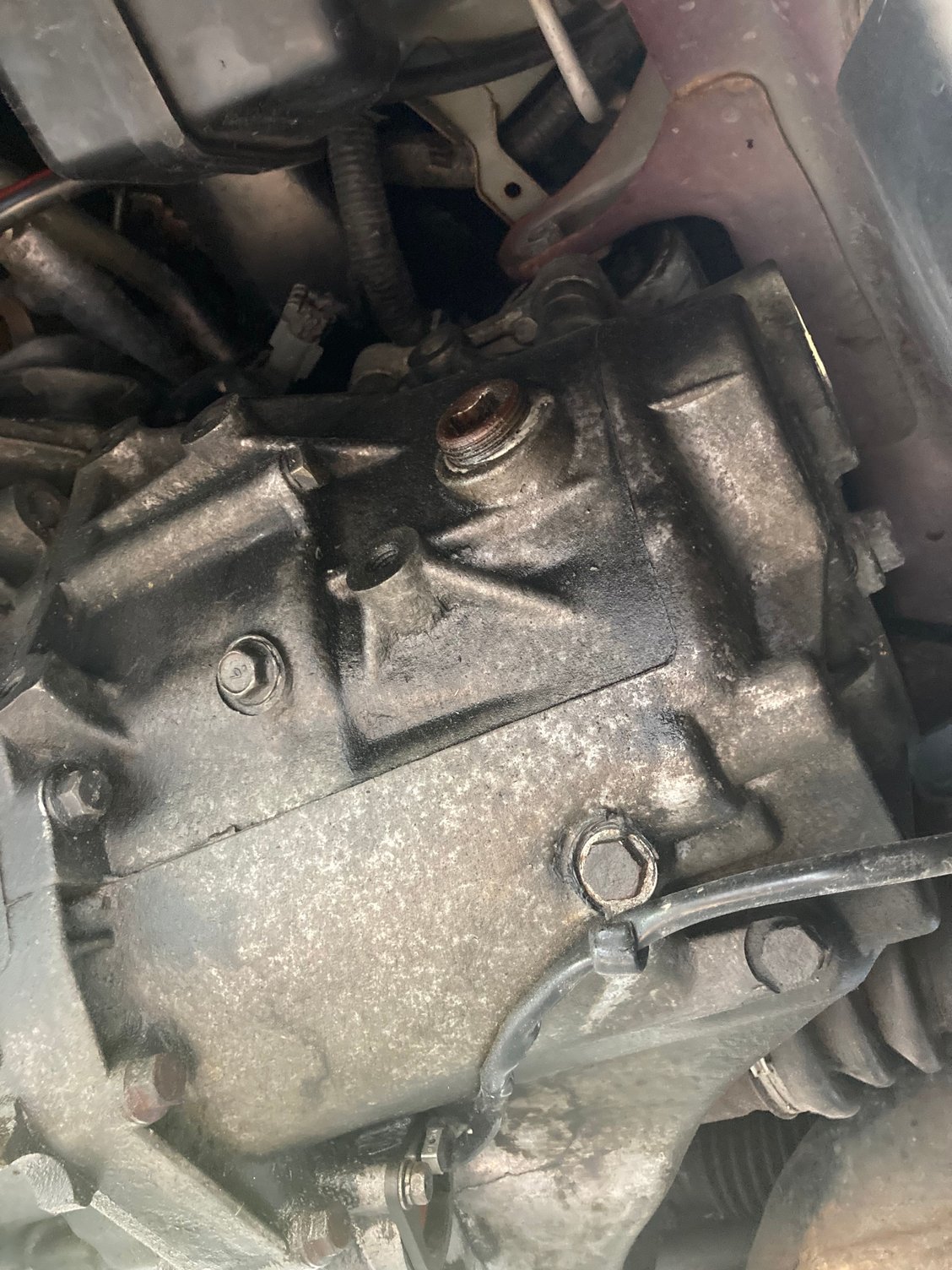

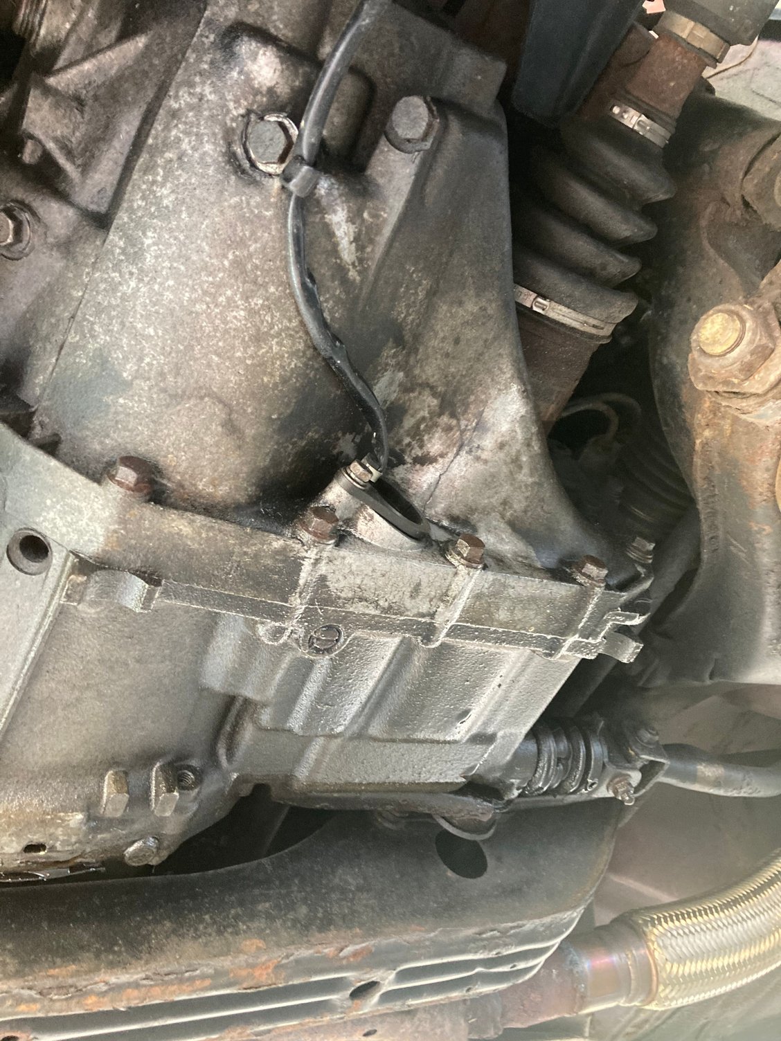

also would the drain plug happen to be visible in either of these pictures?
Old Sep 23, 2021 | 06:17 AM
98 i30t 5spd's Avatar
Joined: Sep 2017
Posts: 215
No, but that is your fill plug on the first picture. The drain plug is on the opposite side, near the crossmember like Jsutter mentioned.
