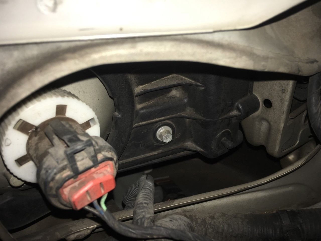

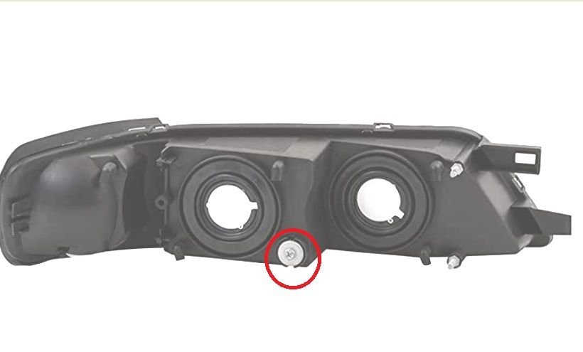

There should be a screw or bolt on the back lower inner corner of the low beam reflector. Turn it clockwise and it will bring the beam down and vice versa for the opposite. You cannot aim them up/down or left/right independently like stock.
Good correction, Chris!
I was definitely not remembering the stock setup correctly.
There is a screw on the back side of the housing for UP/DOWN
Separate from the L/R Adjustment on the Front
The aftermarket, 1-piece housing only has the single UP/DOWN adjustment screw as you correctly pointed out
