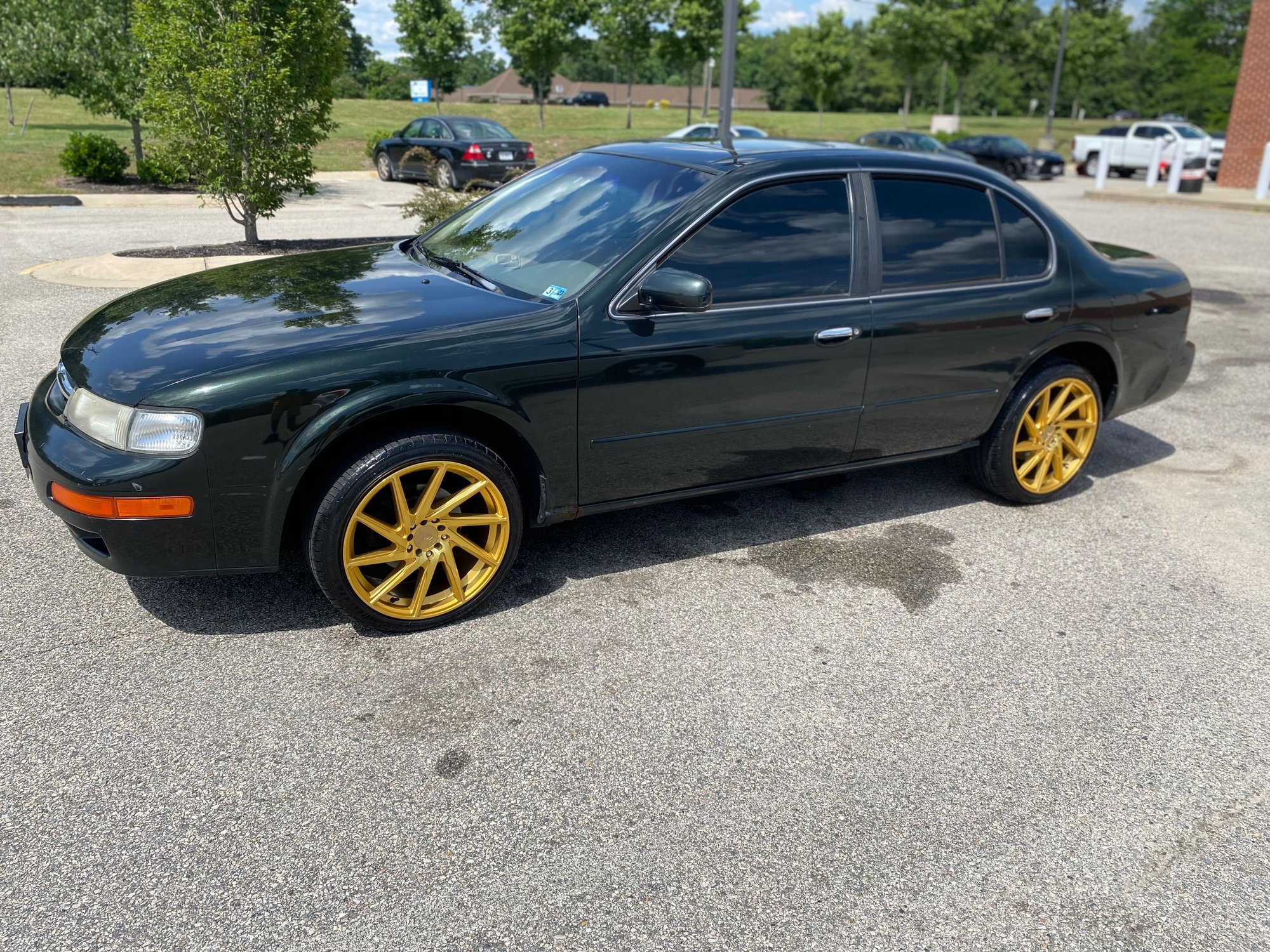

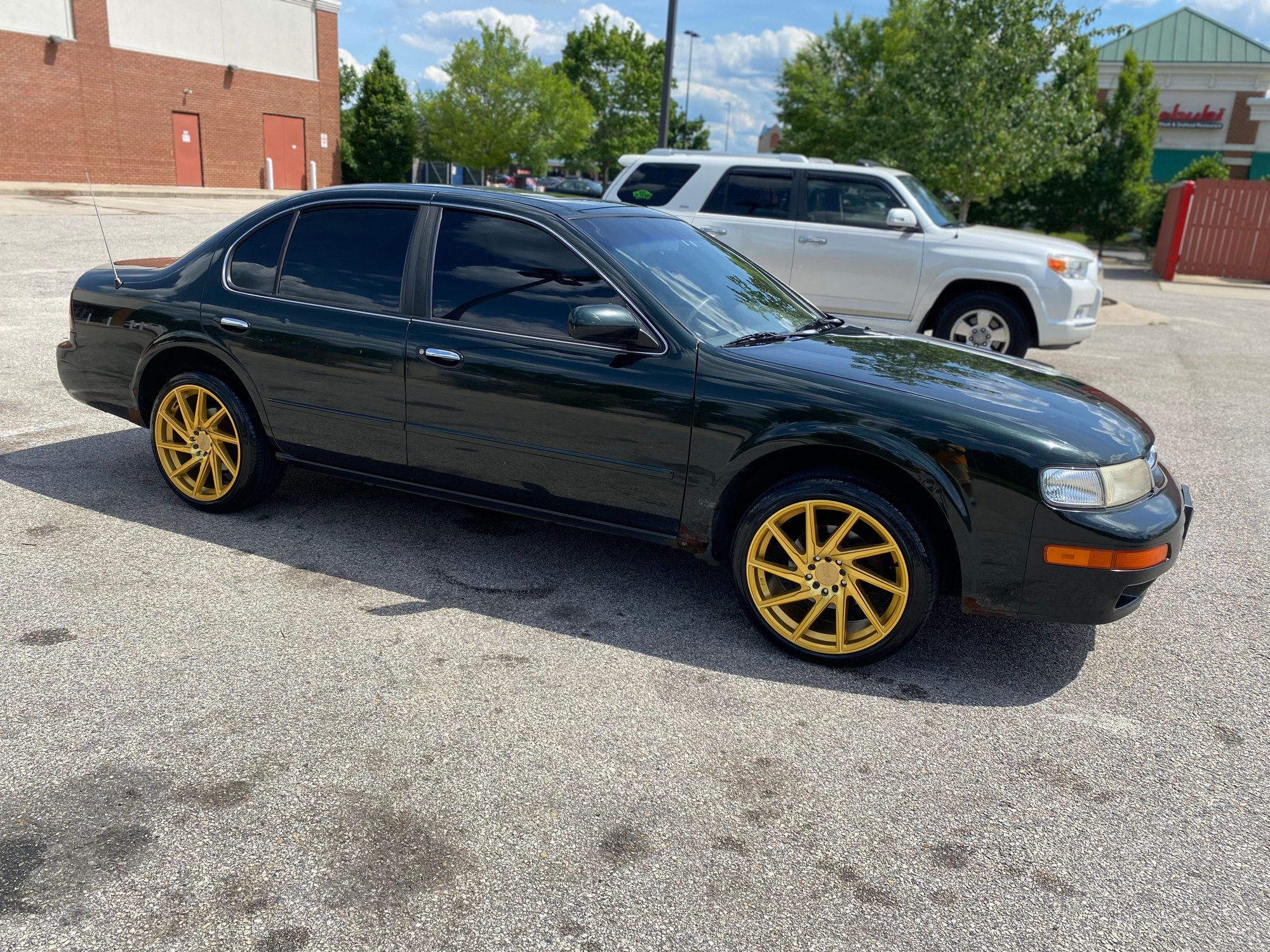

It’s been a while since I been on the org and many parts I’ve used are no longer available? I’m looking to lower and tighten up my suspension and upgrade my brakes? What’s the best way to go these days ? I also want to get nice exhaust system and some new taillights
